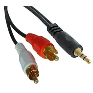

Some of them have optical in which would be ideal for you. There'd be no loss of quality over a digital connection.
If you don't have that, then the red and white phonos can go into your mac line input, but the quality probably won't be super.
You'd need this bad boy.

I have that lead that you showed me, what program do I need to run to get a signal?
James
Audacity's fine.
Open it up, tell to to record from line in, hit record, then play your tracks from the Akai.
