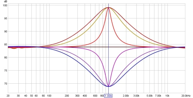

If you mean the graphs on that page, they are actual measurements of gear that I took myself.

Here's a parametric eq filter at max boost and cut, and at three different Q settings. The inner one is the highest Q, the narrowest bandwidth. It affects the center frequency the most and adjacent frequencies progressively less. The narrow bandwidth is the most selective, the wide bandwidth is the least selective.

Okay I think I understand it now..using the graph-1k is boosted the most @ 98dB while 900 on the left and 1.25 k on the right are boosted @90 dB and it gradually slopes down and evens out @ 84 dB on the left at 300 hz and at 3k on the left..
That's basically it. The only thing is that the software I used is meant for measuring speakers, not processors, so the graph is meant to show sound pressure level dB rather than dB relative to a zero point. So the flat line in the middle should be 0dB and the curves should be +/-15dB.
