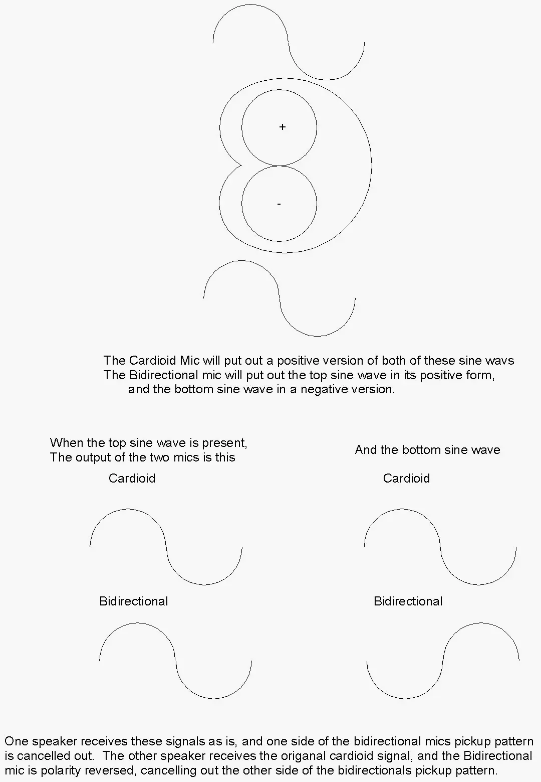

Yes, M/S (which stands for Mid/Sides, by the way) does give a very strong stereo image, though not as wide as a spaced pair or Deca tree, it is wider than an XY setup, and potentially wider than ORTF. If it is recorded to three channels, you can control the perceived width, which is pretty cool.
So, how does it work? Let us first explain exactly how to set up M/S. You want the capsules as close to coincident as possible, which means that in a theoretical sense you want them in the same place. That is of course impossible, but you can get them very close. There are two mics, one figure-8 (bidirectional), and another one. The other one can be almost anything, including another bidirectional, but is usually a cardiod. You split the signal from the sides mic (the bidirectional) and send it to 2 channels. Do this after the preamp, by the way, as mic level signals are not really strong enough to drive two preamps with out some kind of transformer. To start with, pan the sides mics right down the middle (or to one side or the other. The important thing is that they are paned exactly the same.) Flip the polarity of one of the channels. Set one channel to unity (0 dB), and adjust the other until the sound disappears. Now pan the two channels hard left and hard right. The sound will reappear, but it will not be stereo, or particularly interesting. Now bring in the mid mic, and pan it right down the middle. As you adjust the level of the mid mic, the stereo image will seam to become wider and narrower, and you will have stereo separation of the two sides of the sides mic.
So why does this work? It is an issue of phase incoherence. When a sound arrives on one side of the sides mic, it creates a positive signal, and is creating a positive signal on the mid mic at the same time. If the same sound comes in to the sides mic from the other side, it creates a negative signal in the side mic, while still creating a positive signal in the mid mic. This cancels out in the speaker which is reproducing both mics in there original polarity, but in the other speaker, the sides mic has got its polarity reversed, so the sound is not canceled out. Of course, the sound which originally came in with a positive phase is now negative in the channel with its polarity reversed. I have included an illustration, which will hopefully be helpful. The drawings are a little rough.
