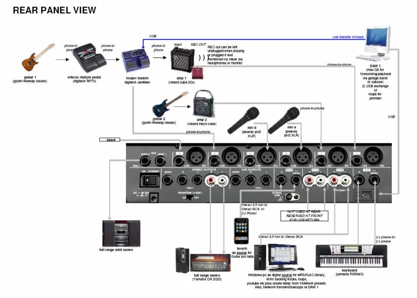

16 inputs is not too much for me (even for home use for fun) as I already have them all assigned ( for use with mac G5):
1 - Guitar 1 (via amp)
2 - Guitar 2 (via amp)
3 - Mic 1
4 - Mic 2
5 - JamMan looper
6 - Spare
7/8 - Keyboard
9/10 - An old Windows PC used as library for MP3, wavs, etc
11/12 - reserved for USB return
13/14 -i touch guitar pro tabs (guitar toolkit app)
15/16 - reserved for internal effects (only bypassed if front panel jack used)
UPDATE: I drew up a pic, attached
