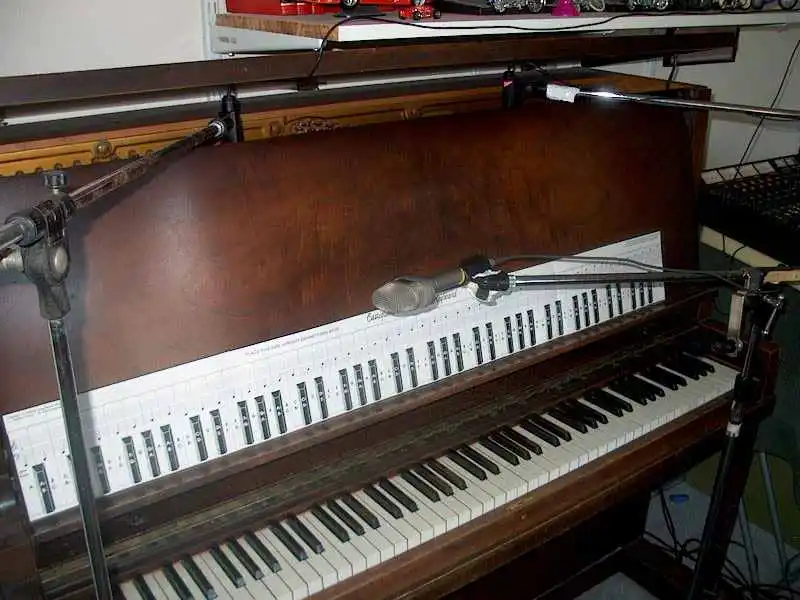

1) Piano was mic'd with (2) TASCAM ME-20 condenser mics. They were mounted on boom stands and inserted into piano thru top and pointed down, with one over C 2 octaves below Middle C & one over C 2 octaves above Middle C.
2) Vocal was mic'd with one side of a TASCAM ME-210 stereo mic. I think that's the number, anyway. Mounted on boom stand for piano position.

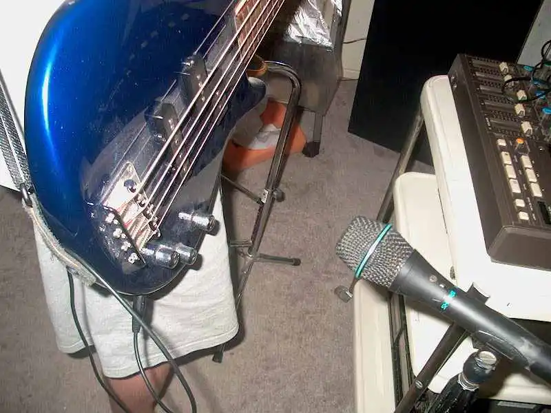

4) Bass was DI plus close mic for snap using the Shure BG 5.0 again. When I use DI guitars or basses, I'll always use a close mic to supplement. That's my rule of the road. I cannot tell a lie, the bass track was done on the 244, as I'd been transporting the tape back and forth for tracking and proofing. Got a little lazy with the tape swap and just popped the bass track on using the 244. No big diff. 244 and 246 are about 8' away from each other in different rooms. One's on the monitor and one's not. I just swap the tape over to get a quick listen, and so it goes.

TOP: Shows the (2) TASCAM ME-20's setup for piano and (1) TASCAM ME-210 setup for vocals; both piano & vocal tracked live to tape onto Tracks 3 & 4, respectively.:eek:;)
Note: the TASCAM ME-210 is a stereo mic that I only used the left element for this track.
BOTTOM: Shows how I usually put a close-mic on any electric guitar or bass track when recording Direct-In (DI). Mic is usually on high gain to pick up ambience. I use this technique on all my e-guitar and e-bass tracks, as a rule. That's the "secret" of how I get a characteristically good & live sounding guitar/bass track without using amps. I'll use DI just alone or with an efx box sometimes on guitar, then the close mic to liven it up. I swear by this technique.:eek:;)

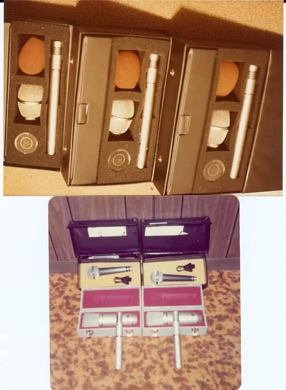

Many years ago I used to use three Teac PE-120 mics in the studio. The mic came with both cardioid and omni capsules. This thing used a very odd 4.5 volt (I think) battery. The battery was nearly impossible to find at the time. I eventually found a few of them at a camera specialty store in Minneapolis. The picture attached is from about 1977 or so. The mics shown in the lower picture are Beyer M-500 ribbons, a pair of Sony C-22(?) condensers and a pair of Neumann U-67's. I wish I still had the Neumann's. :eek: Whatever happened to shag carpet anyway???
