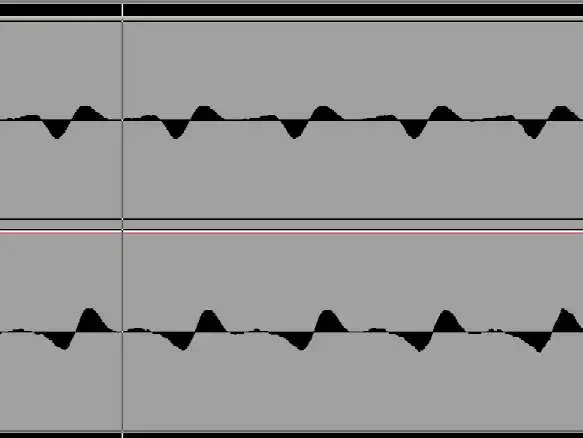

I manually phase-aligned the tracks in the software.

...nice...can you be more specific about the "phase alignment" process?...

Just zoom in on the waves and line them up, so that when one goes up, the other also goes up. Since they're both recording the same signal, the waves should start and stop at the same time. You just need to make the slight adjustment since the capsules aren't in the exact same place. If the mics are at different distances from the source (mouth), then you might have to flip the polarity of one signal to get them to line up properly. It will look something like this:
