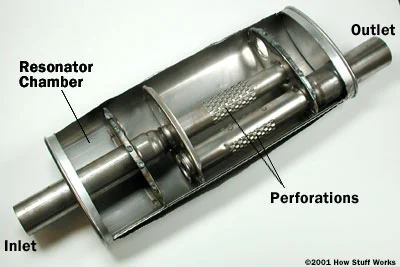

Here is my design for a vocal booth, guaranteed to give the all too common muffled sound.
How it works, you sing into the inlet while sticking the microphone into the outlet. The people around you can't hear your voice and the mic does not pick up outside noise. Plus you can pack it away when finished.
Alan
