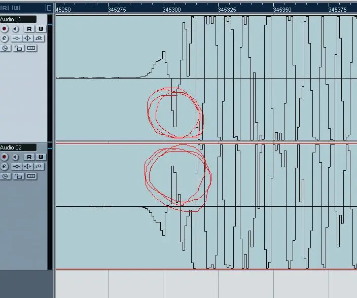

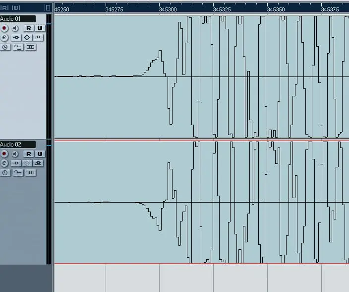

If they are group buy mics, check the silk screening. Mine are actually in phase, but one of the bodies is silk screened 180 degrees wrong making me THINK it was out of phase, but not. Recording a fingersnap in fig8 on both sides will show you which is +. It will be the "rising" waveform in your DAW.
