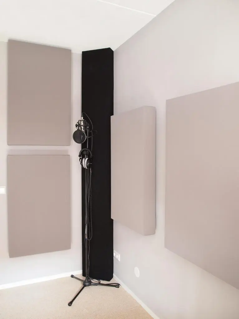

New Studio build.
Hello, All.
I'm building a new recording/rehearsal space and I posted some photos.
Go to my profile and take a peek at the "New Studio Build" album.
Tell me what ya think.

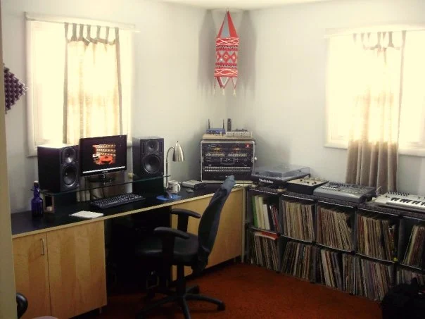

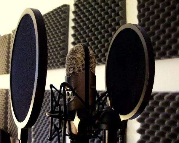

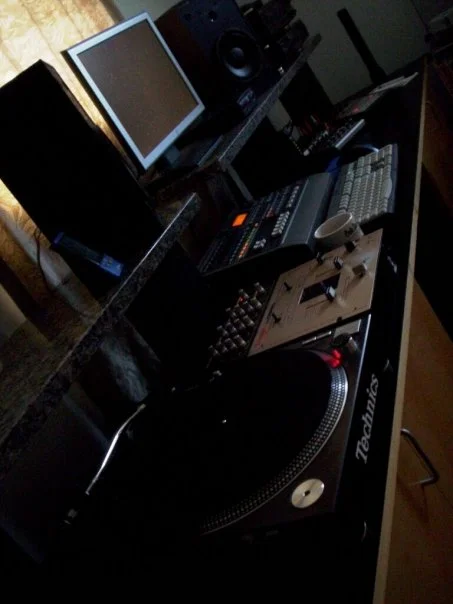

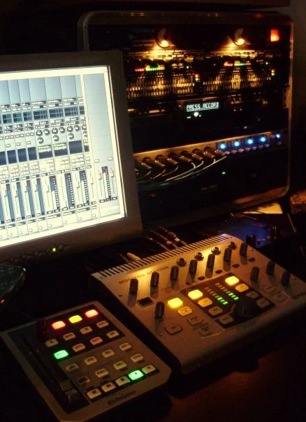

Here's mine..
My setup from Holland.. well part of it.. doing most in the box :p

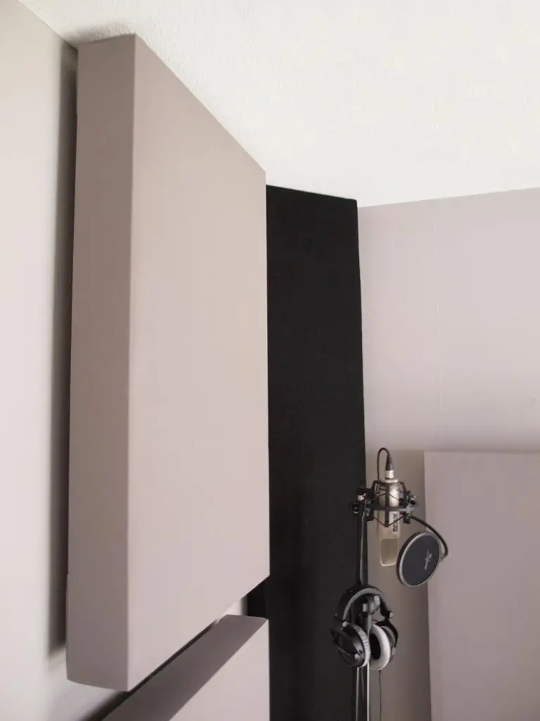

Actually I do have one thing to point out: I see why you made the corner traps that narrow, but it's typically not a good idea as it decreases their effectiveness quite a bit.

I thought that too. Narrow and packed into the corner...Still, they look sweet...I have plans to make hinged corner traps that can be moved around out of the corner and opened for different applications (gobos)
Yeah it does look nice, is it a regular 2 or 4" panel, or triangle pieces in superchunk form? A thin superchunk would be as effective as a wider flat panel.
What about corners? Other than that observation, it looks great!

Ceiling and wall corners...yeah, I'll have to build up some cash to add those to the list :)
Word. Ahhhh...just one other thing: you might want to think twice about the skyline diffuser flanked by two bass traps. I've got no problem with a couple of 2'x2' QRD's striped between (or on the sides of) your bass traps, but the back wall should probably be primarily used for bass trapping. Some of the worst peaks and nulls will come off the back wall, and the skyline really won't do much about them...unless it's 9' deep of course. :D

My other thought was a curve...your thoughts?
Or should I just go with 3) 705's right in the center?

I know where you're going with the poly cylindrical idea, but I'd go with at least 4" of 703 or 705 on the back wall. Thicker panels made with 705 move the power curve for absorption down lower while becoming less absorptive from 1Khz on up...that's pretty much just what you're looking for in a back wall bass trap. You can mix up some diffusion back there either between bass traps or on either side.
