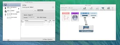

In the Apple app "Audio MIDI Setup" I connected the keyboard to the US 144 as per attached image. Seems right to me.
