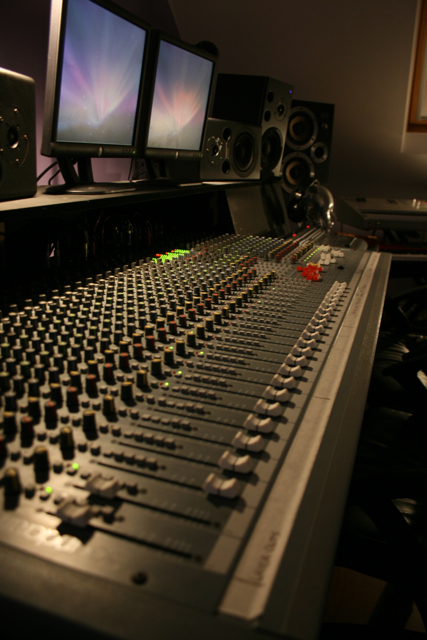

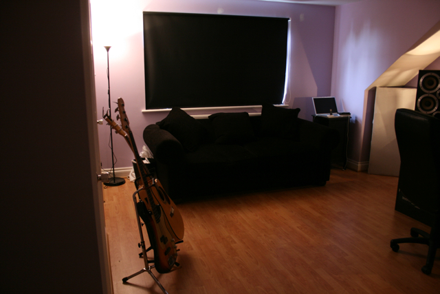

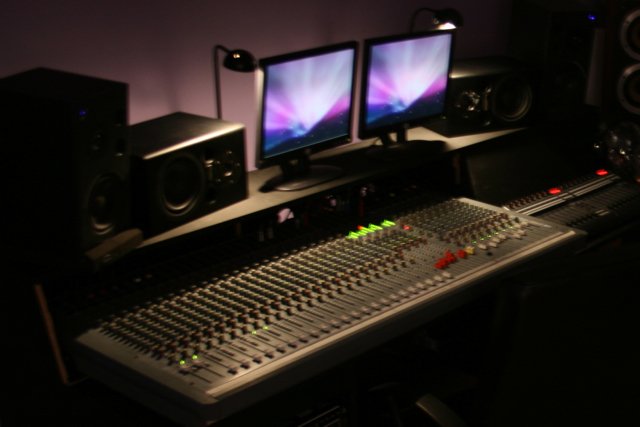

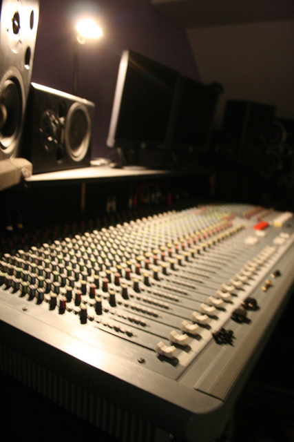

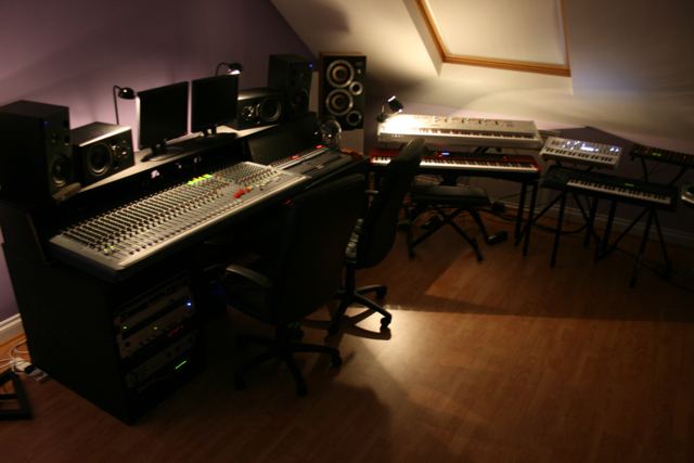

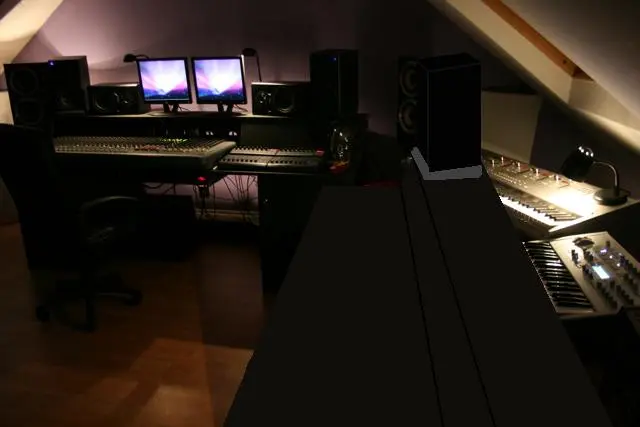

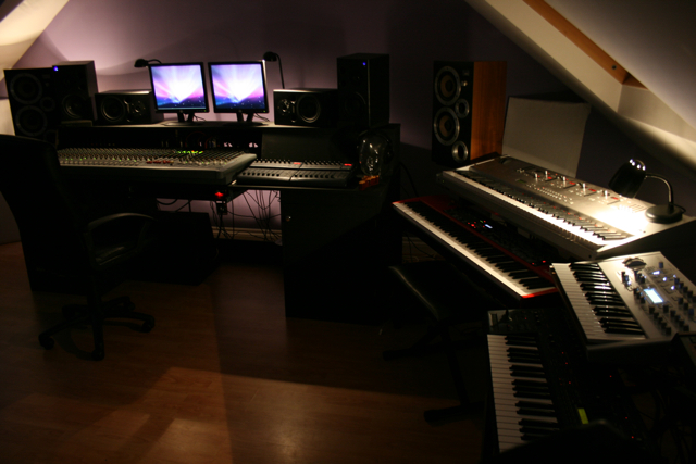

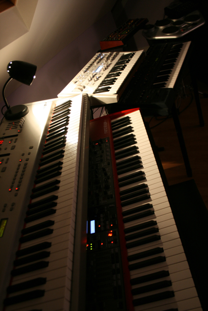

I just moved house and now have tons more room for my studio!
Here are pictures of the control room, we also have a drum room which I will work on and get pictures up as soon as possible :)
Time to make some music! :D
That room is attractive. But it looks in disparate need of some treatment. It must be a flutter echo nightmare.
Well, i've begun with treatment.
We have two bass traps in the front two corners. I'm going to build some for the back ones too.
Would a diffuser do for the wall behind the desk and also the rear wall?
I can't do much about first reflections due to the /\ shape of the ceiling, but.. seeing as the room is a very irregular shape anyway it seems to be quite dead.
Any ideas?

I think you'd be better off facing the sloped ceiling and firing down to where the sofa is. This will allow you to get a good stereo image (atm you have one sloped wall and one vertical which is bad). For a budget/home studio, I believe you're better off investing in absorption than diffusion. You get a lot more for your money.
With your monitors on their sides, shouldn't the woofers be more central, with tweeters to the outside? This will give you a wider stereo image.
You should get bass traps in as many corners as possible (even 2' panels in the corners under the sloped ceiling), have panels in the side and ceiling reflection points, and on the back wall. If you change your setup to what I suggest, you would do well to hang a heavy curtain at the window. This, along with corner bass traps and sofa, would do for the back wall absorption.

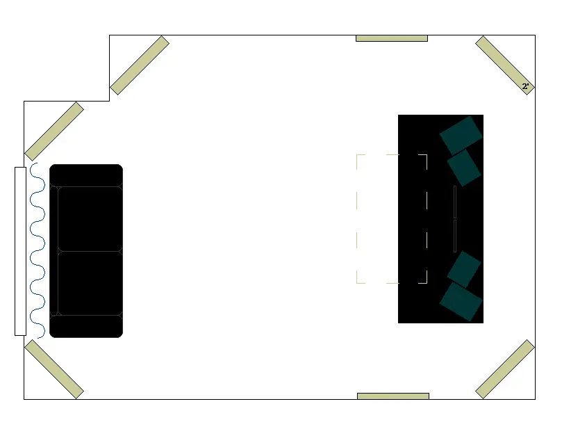

Here's what I'd do:

Here's what I'd do:
The slope is too steep to put equipment up against im afraid. But yea, that would be ideal but it wouldn't work with the equipment I have. Those fostex are not turned on as one of the tweeters are broken. But yea, I will have them standing upright when I fix them!
I understand that the slope is too steep, but you should just space it far enough that the equipment does fit. It's a much betetr placement than the one you have at the moment for many reasons.

@pandamonk: I would have to have that desk pretty much in the middle of the room as it would not fit height wise anywhere near. Also, the room shape is slightly different to as you have drawn it. I'l draw you up a sketch at some point tonight!

I've sketched where I think the desk could go (It seems like it could even move further back than I've drawn), with around 2-3' space behind the desk.
People definitely do go overkill with thin absorption, but most don't have enough bass traps. Bass traps, on their own, shouldn't suck the life out of a room. The corners take up so little of the room that you could completely fill them with bass traps and still have the vast majority of the walls still bare.
The bass in most rooms seriously needs to be tamed to have any idea of what's going on down there. I'm sure everyone here has experienced one note bass. And I'm also sure that everyone has listened back on headphones, to a track they have mixed through their monitors, and been amazed by what they had missed. Absorption in the first reflection points greatly improves your ability to hear what's going on in the mix!
No-one is suggesting you cover all the walls, just all the corners and the first reflection points. This keeps the liveliness of the room but still treats the major problems. This is all I, and most people here, suggest.

Yea, the desk can't go there. There is another part of the room which I have not photographed which would be blocked off if I put the desk there. Not to mention it would be a ton of room wasted. Surely the sloped ceiling on the right won't be too much of a problem? I always thought irregular shaping was better than symmetrical, but I could be wrong!

Yeah. Well when people recommend bass traps, they're not talking about wall to wall 2" absorption. A dead environment is a horrible place to record/mix. No-one here, who knows anything about acoustics, is recommending that.
No, you want symmetry in a control room. If you don't have symmetry your stereo image will be skewed. Ah, I didn't know about that part of the room. I see it now that I know about it. Where I recommended wouldn't be symmetrical either then. What's the drum room like?
You could maybe get away with it where it is if you have solid back absorption panels in the first reflection points.
I can't really work out where my reflection points will be. One would be towards an angled wall, which would surely be enough to re-direct the reflection elsewhere? The other would be where the blind is in my room, so unless I get curtains or get a gobo I can move when I mix, then i'm not sure what I can do.
