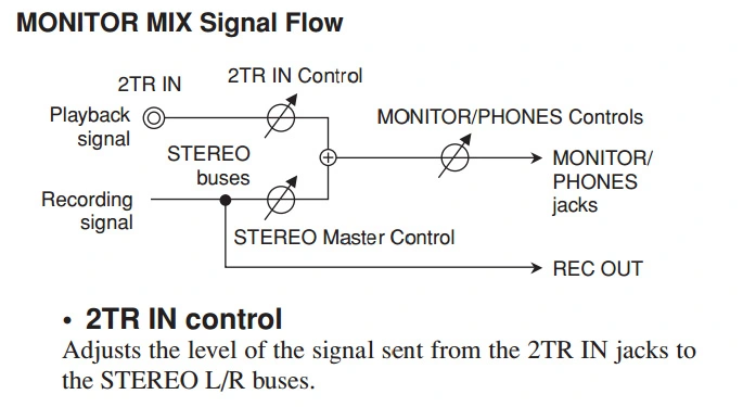

I suspect what you're missing is the "Monitor Mix" knob. Bring your PC output into the 2-Trk in (as you've done), set the switch to send this to the monitor (not the main mix) then use the Monitor Mix to balance the levels between PC playback and live stuff on the mixer inputs.
The signal flow diagram gives this information (rather badly).
tthat switch ONLY toggles where the 2TR jacks go ..... it's labelled as such. It lets you send those two signals to the monitor OR to the stereo.
From what I'm seeing in the pic I pulled up ..... the headphones should play whatever comes out of the 'stereo out' jacks. Of course the channels need their main volumes up ..... the sreeo/phone knob needs to be up and possibly the stereo/master volume needs to be up.
If any of those are down you wouldn't get any signal.
That's all I can see unless there's some switching on the back of the board I can't see.
The switch only does that toggling as you say--and obviously you don't want to loop the PC out back to itself, hence my comment about setting it "To Monitor".
The important thing appears to be the Monitor Mix knob which, if I read the manual correctly, provides the same function as a similar control on an interface, allowing the OP to mix what he hears in his headphones between the PC out and the input channels on the mixer.
