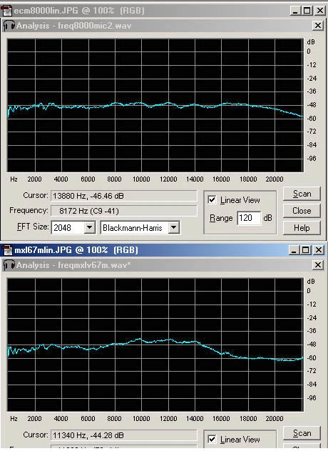

Marshall's frequency response curves show the v67 with a 2-3 dB rise from 10k to 20 k. They show the 2003 with a flat response from 20Hz to 20k, then some strange 20k to 23k region on a different scale than the rest of the graph showing a 6dB rise. I have to take that and the flat response from 20Hz to 50Hz with a grain of salt - doesn't give me a lot of confidence in Marshall's curves.
I checked the response of my own v67 using my own flakey methods I posted elsewhere in this forum, which showed -50dB@7k, -42 dB@10k,-43dB@12k, -44dB@14k, and-56dB@16k, a 12dB range. Attached are linear curves for the v67 compared to the ECM8000 for reference. This was the basis for my comment about the v67 freq response.
To my ears (which are neither flat nor experienced) my mic does seem somewhat bright, especially when compared to the SP B1.
However, I will certainly defer to your experience and your ears, and the possibility that either my individual mic is an outlier in the v67 population or that my test methods are full of shit. :)

Frequency graphs aside, I am going to comment with what my ears tell me about the two mics, since I own both. This is all subjective, but I found the V67 more colored than the V93(same mic as the 2003). The V67 seems to have a bit more of a full bodied sound in the low mids. I never found it extremely bright either. The V93 has less of that full bodied sound, which makes it seem more neutral in use. It does seem to have a bit more high end, but its upper high end and it seems very smooth to me.
