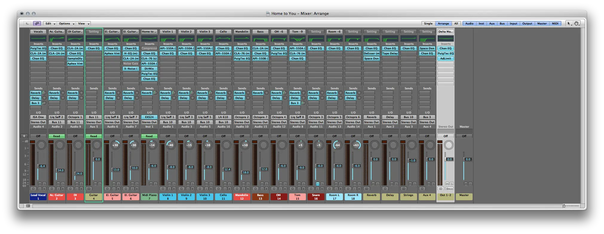

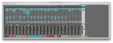

PaddyGordon
Delta Mainline - Home to You (Rough) - YouTube
This is the mix
Vocals - Neumann KMS105 (Through Focusrite ISA One)
Guitar - Shure SM27 (Also DI'd)
Mandolin - DI through ISA One
Electric Guitars - Shure SM58s
Tom - SM58
Snare - SM57 (Not used in this track)
Overhead - Rode NT1a
Violin 1 - Lewitt LCT140
Violin 2 - Neumann TLM 102
Violin 3 - Shure Beta 58
Cello - sE X1R [Through LA610 Mk II, compressor Bypassed] (ended up picking up a shitload of other stuff so you can barely hear it in this mix)
Room Mics are 2x sE 2200a's in an X/Y Setup
Piano is via midi and is using the Braunchweig Upright Sample via EXS24 (from imperfect samples)
