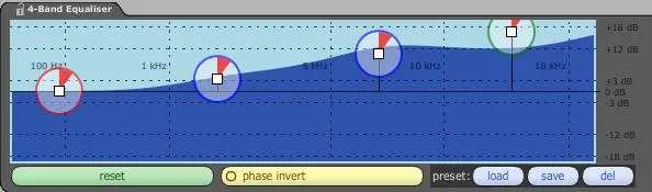

Yes, it’s recorded in stereo, but I haven't seen a tool that works as you described. But I toned down the bass notes, and, hopefully, evened out the piano sound with a 4 band eQ. Before, the first two bands (bass frequencies) were set much higher, and closer together. I can’t say I totally understand what I’m doing as I move things around, I’m just listening to what it does as I change it, and what sounds good at the time (in my headphones). You may also note that I haven’t touched the Q part, because I don’t notice much of a change whenever I’ve tried to play with that part. So, I have even less understanding of how I could effectively use that tool. Piano eQ settings (please see below for the pictures - it's the first image).
I would like to hear the piano pushed back a bit and the vocals lifted a bit more (but that's a personal preference). However, pushing the piano back a bit may resolve some of the spatial issues raised by rayc.

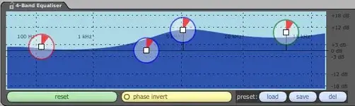

Hi Mike! It was so nice to hear from you! Thank you for your comments. Can you offer a bit of coaching, based on the pictures I included (piano is first, then the settings for my vocal track)? Oh, and I have a bit of reverb set for each of these tracks as well. I know you tried to help me understand the reverb once before, and you explained settings that would make something sound nearer/further away. I’ll go review that correspondence while I wait to hear from you guys, and see if it makes more sense to me now. I’m very pleased to hear you say you think I’m improving. I think I’m a slow learner with a lot of heart and fortitude!
