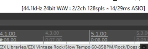

I often just play my guitar through the computer with effects and processing - never even pressing record. the latency is 9ms, and while I can hear this it's hardly noticeable.

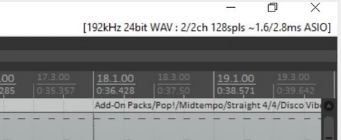

My set up is pretty low latency. Apollo with Reaper at 1.6/2.6 ms.

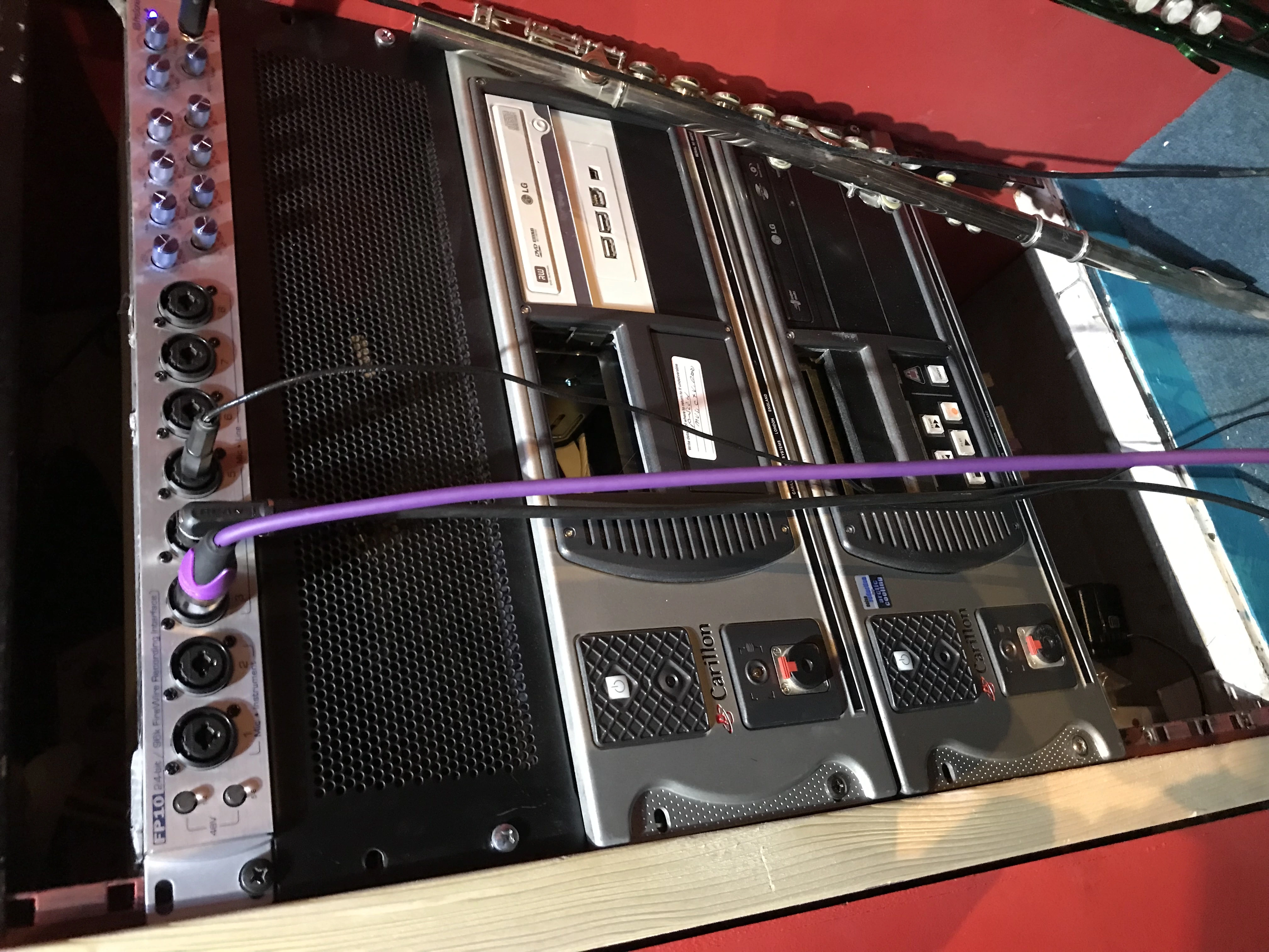

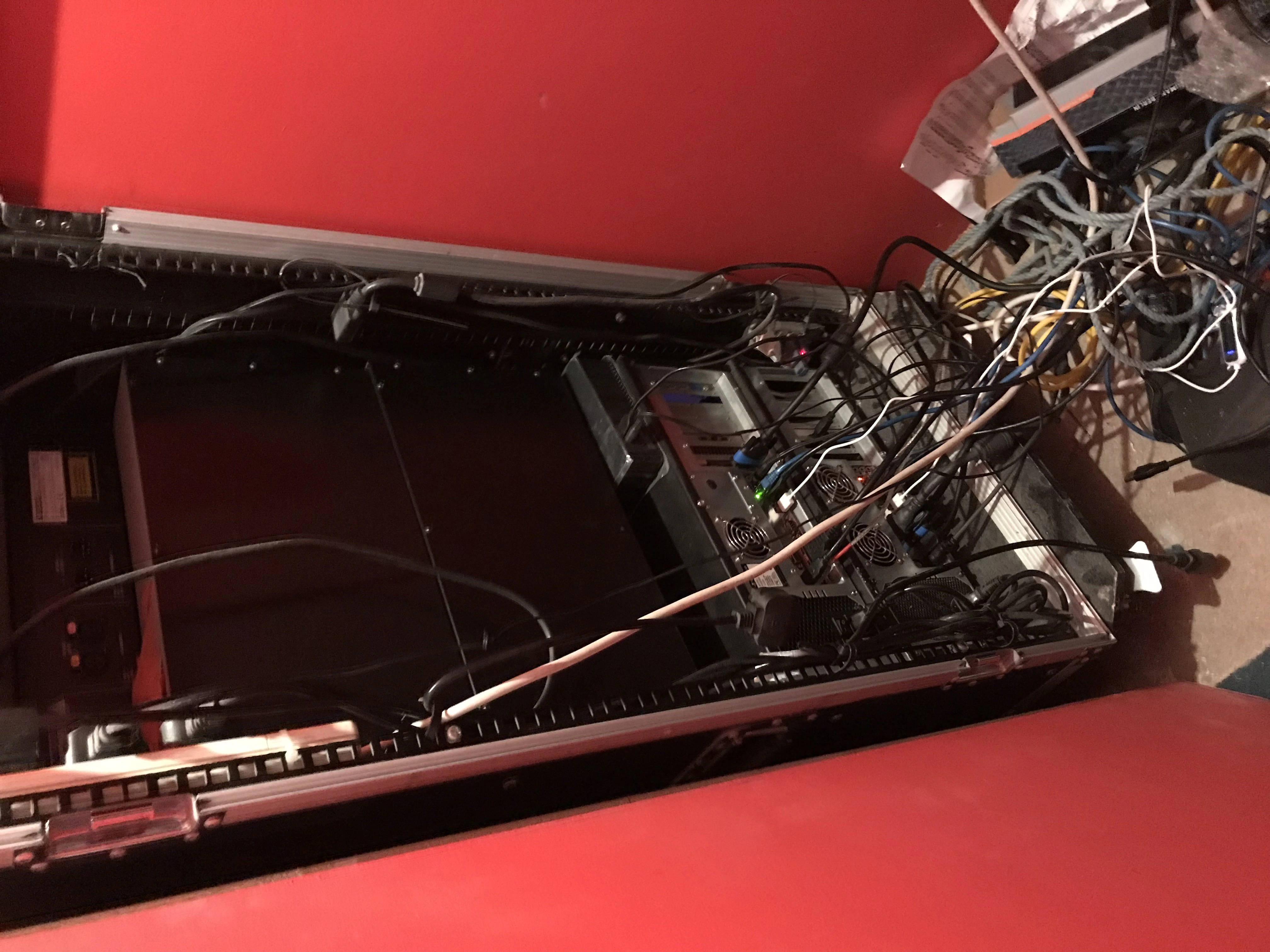

It helps sure. I can price those on Ebay and get a sense. How would you describe the noise from that machine in terms of fans and other sounds? I'm looking for an extremely quiet or silent computer situation.

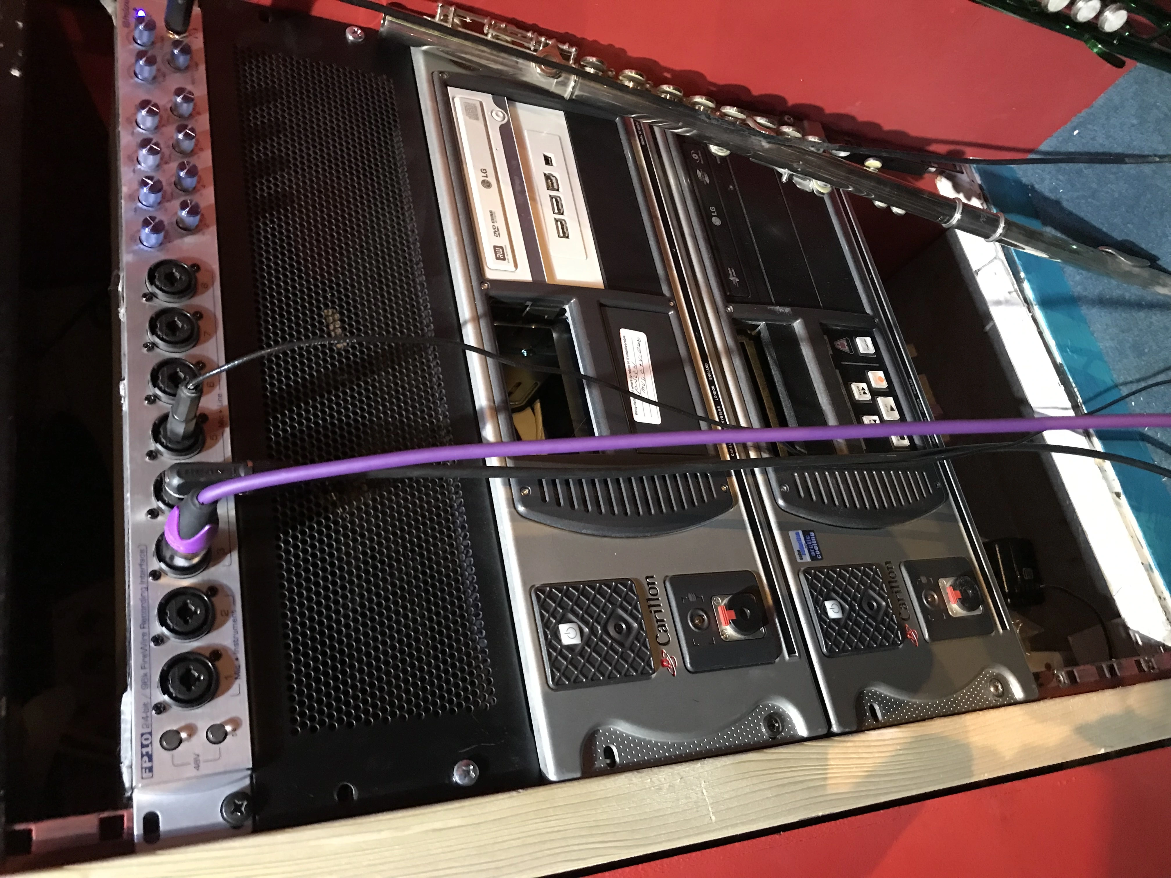

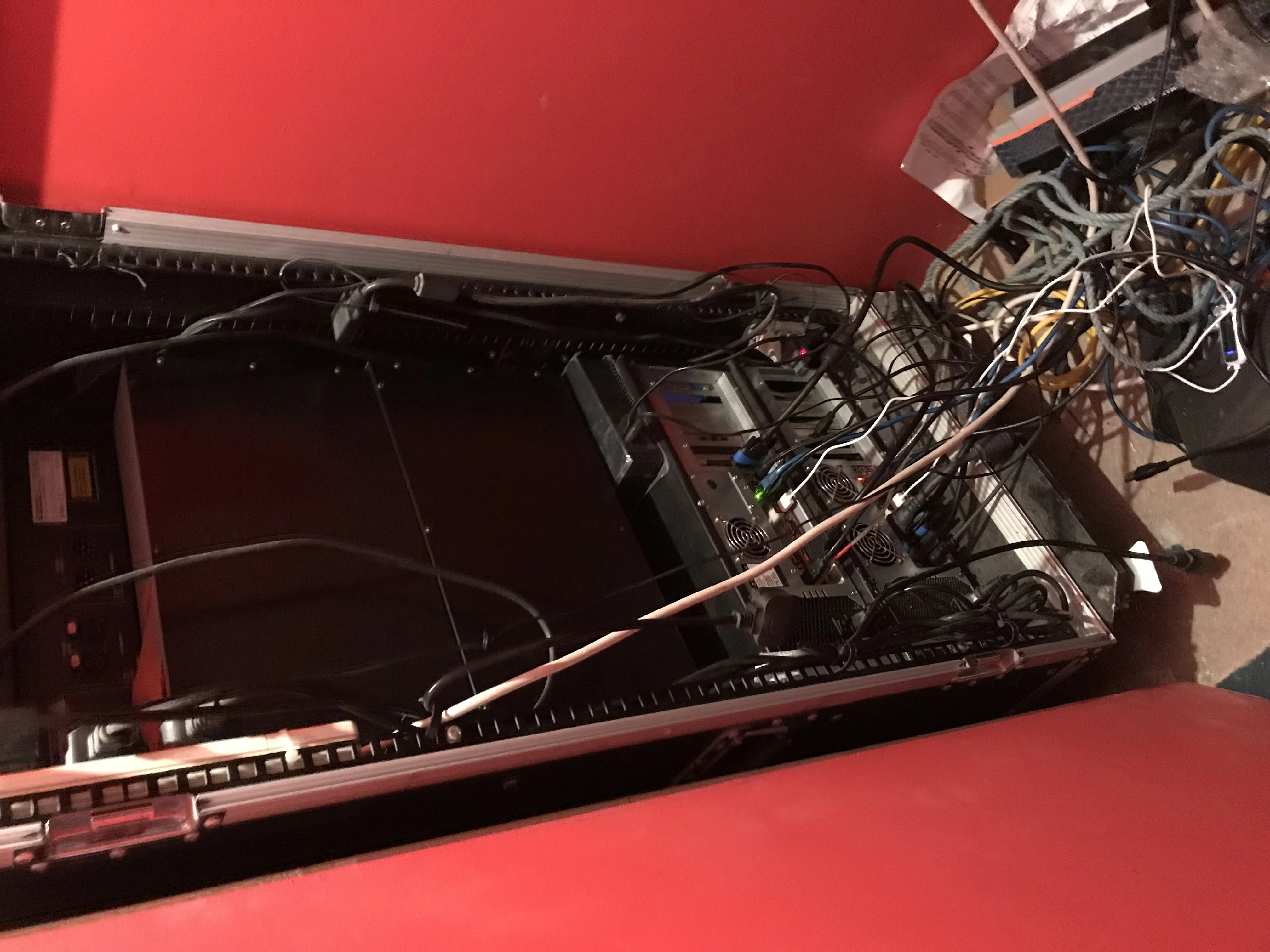

Dreadfully loud. Hence why both the studio computers are elsewhere and not in the room I work in. When you add more processor power the need for cooling goes up and worse, because I leave the computers on 24/7, one of them is suffering from noisy bearings too. The one in the video editing system is noisier because it has another fan in the video card. The box is important too of course - this untidy mess is the rear of the computer rack that I'm using and the cables vanish into the floor and come up in the room next door.car1.jpgcar2.jpg
This is the two old computers, now waiting for when they need to take the place of the others in the rack - they were too noisy - despite being in a rack, as the ventilation let the noise into the room. I've been recycling these 19" housings for years now. I bought an original carillon and the case has outlived the innards many times over now. I actually have 6 identical housing in my two locations - When I bough them, they were really expensive but have toured and done loads of miles and kept the computers totally safe. Not a bit of plastic! All metal and mega heavy - but one overheated with what was inside, and I had to remove the front 3.5" covers to get more airflow - and of course that made it noisy. They have two fan ducts on the rear panel, but with big video cards inside, moving air around means bigger processor fans and two axial fans - noise is a pain.
