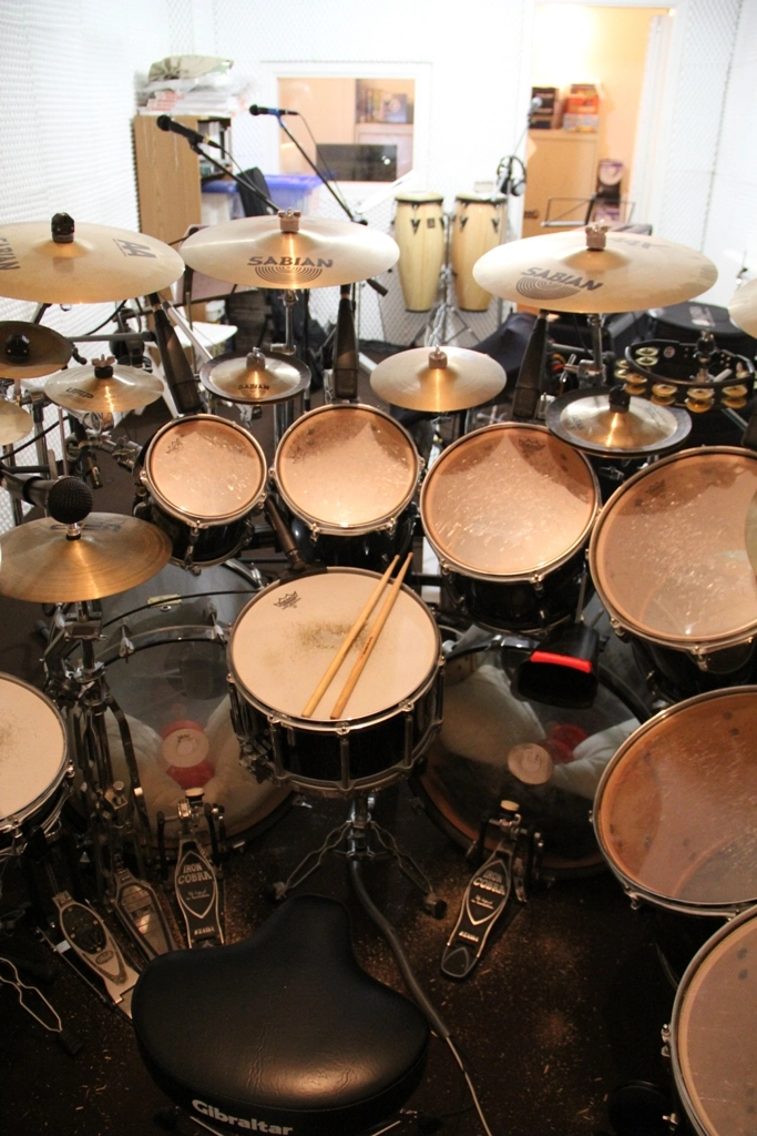

I have a small home recording studio, where my drums is permanently mic'd. The mics signals go directly to another room into 2 x M-Audio Profire 2626, connected to a PC with ProTools. That is fine for *recording* songs multi-sessions: 14 slots are taken by the drums, 2 slots are left free for any other stereo use (vocals, guitars, etc.), and we can record multiple tracks.
When we rehearse, we use the same room. In the room, I do have a Behringer XENYX 2442FX, connected to a PowerPlay headphone amplifier (we play with headphones). In the mixer I use the following inputs: 1-guitar, 2-bass, 3/4/5/6-vocals, 7/8-drums (stereo return from the Profires). The output of the mixer is connected to a Notebook.
