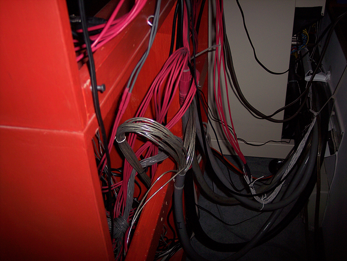

First I had to clean up some of my old wiring and also move some gear from one rack to another.
Along with the wiring clean up some old PBs were removed, and I made room for the new PBs.

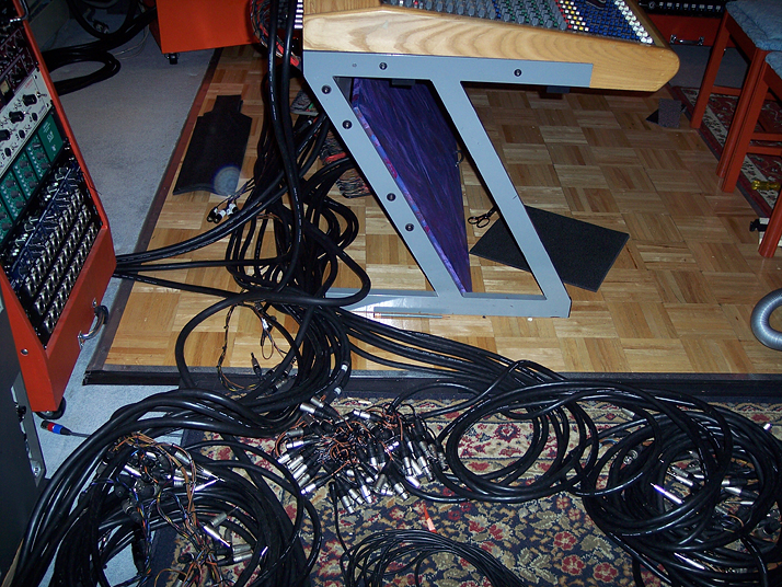

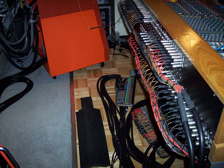

These are the new PBs and new snakes that came with the console that I have to sort out and adapt to my setup.

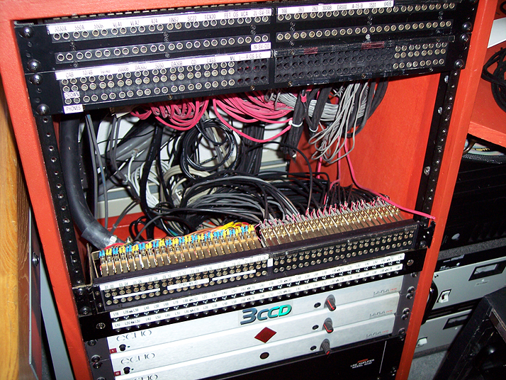

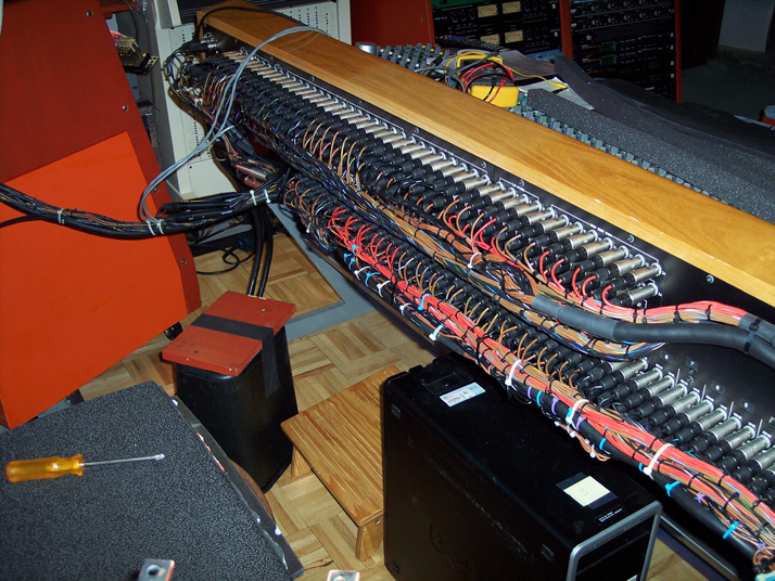

Got the first PB hooked up to the back of the console, and installed in my PB rack....4 to go.

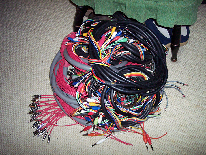

This is all the old wiring that I removed that is no longer needed.

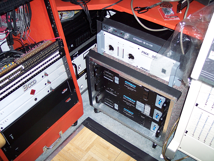

This is the new A/C power supply setup...all Furman units. 1.) There's a power relay (not shown) that acts as a breaker when the power goes out to keep it from suddenly coming back up, allowing my to manually power everything back up.
2.) then follows a first layer of spike/surge protection, 3.) then a second layer of spike/surge protection and also voltage regulation, 4) and then finally a balanced power unit that feeds the whole studio.

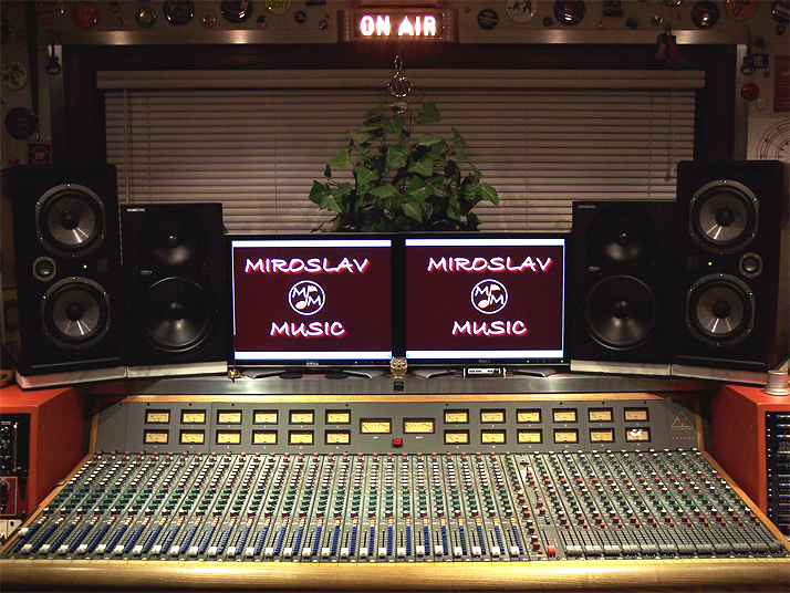

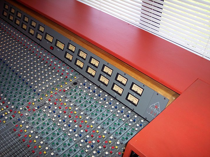

I also had to build a new over-the-meter-bridge shelf for my studio monitors and my dual computer screens, The shelf runs across the top of the console from one rack to the other rack and ties it all together so it looks like one unit.
