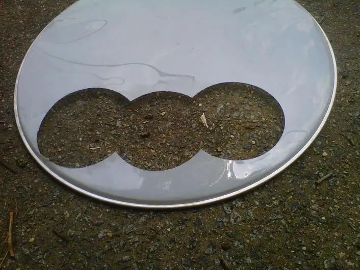

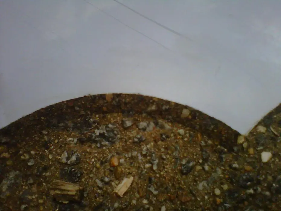

Well, okay, damnit, here are your stinkin' pictures!:D
First one will show you what you want to see- I wish I had put a piece of white paper behind the hole so you could see the contrast better, but I think it shows the minimum of black soot that is actually there.
Perhaps there are faster methods- my reason for starting this thread is just to show that this method works. No doubt there are different methods- "several paths up the mountain," but this one works, too. I think one does not have to remove the head for the hot-can method- I did because the tear went so close to the rim that I knew I would damage something if I tried it with the head on the drum.

Well that's really pretty good. Thanks for the pics. None of the ones I've seen looked that clean. Well done.

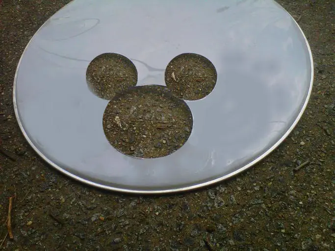

You did essentially kill that head though. Too much material is gone. For those of you trying this: Make one hole just big enough to fit a mic if you want the head to still act as a resonant head.
A new design for those Disney gigs.

The head was split that length, I basically used it for "hole practice." If I'd had to, I would have swiss-cheesed the thing.
Love the Mickey.

You did an awesome job on cutting out the circles....the edges were very clean. Thanks for sharing the pics and how you did it. That was great.

Offend me? Heavens, no! All good fun... well, actually, the Mickey thing was right on the edge...
