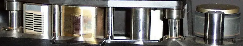

Could somebody take a look at these heads and tell me what you think. It's hard to tell. These are the best pics I could get so far. He has sent me a dozen or so but they were all blurry. I'd appreciate any help anyone can give me. Thanks...............

Sadly, it's impossible to tell. The picts are too far away from the heads and too small. I can't even see the tape lifters very well ... Ask if he has something called "macro" on his camera. When engaged, it's possible to take extreme close up picts of whatever. Tell him to use that. Good lighting helps too. ;)

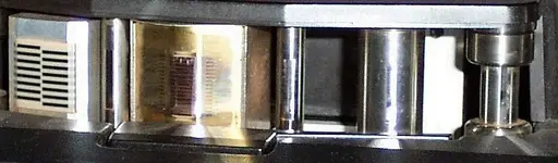

I sent him pictures that I took of my 38 heads (posted in tascam 38 woes)and told him to try and get a picture like that. I also sent him a picture of these heads from my buddy's msr-16 and told him to compare the heads. He's camera illierate. Thanks for your help.

OK, that's a lot better but I sure would have liked a bit more light. (There's too much shadows). Still, I feel this is sufficient for a quick inspection. I immediately can tell that there is very little wear in the way of the tape lifters and presumably the heads, which indicates to me that this is a lower use machine.
My friend, can you tell the seller to do exactly the same pict but add a light source this time ? Perhaps a flash or other. Tell him to make sure it's done the same way, preserving the clarity, but add a flash or some more general light. I've got my LCD set very bright and it's still dark. That way I can more comfortably confirm the condition.

I don't think I made it clear to you. This picture is not of the machine in question. This is another machine that a friend of mine owns. I sent this picture to the guy who has the msr-16 I am interested in. I told him to try this angle with just a bit more room light. If he can get it I'll post it. Yeah this deck the pictures came from is a low hour deck. Check out the picture of the E-16 heads I posted in the Fostex forum. I am trying to make a decision on which deck is the best buy. Thanks again

The heads in the original pics look worn.
The lifters show pronounced flat spots, as well as the record/play head itself showing a fair amount of wear./DA

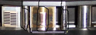

I hope you don't mind me posting the msr picts for you. I've cropped and made them into a smaller file size. Definitely better (and bigger) picts allow to clearly see well worn lifters, tape guides and a definite flat spot on the heads. Don't buy it is my recommendation.

Plenty of oxide shed and generally unclean and worn tape path.

... picts allow to clearly see well worn lifters, tape guides and a definite flat spot on the heads.

The photo 3 posts down (of the original poster's buddy's machine) has a lot less wear than the picts down.
