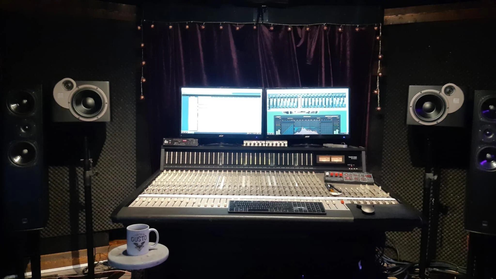

Hi there. I'm Alf from Norway. I'm a newbie here on HomeRocording.com and I have a question for you. Yes I know, these are all old posts but I can't stop wondering; are you guys still using your Tascam M-3500's? I bought a used but very nice M-3500 a couple of months ago but I haven't used it musch as the PSU has hum and noise issues. Yes, it's the PSU. Dried-out electrolytic capacitors and all that usual stuff. I'm thinking of buying another M-3500 for backup and spare parts. I think it would be wise to be on the safe side. Well, are your M-3500's still going strong?? Cheers, Alf :-)
.......and here's my Tascam M-3500 in my studio.

Hi sr71rules. Too bad you couldn't keep your Tascam consoles. They're really great except mine of course, which is haunted by hum and noise issues caused by the PSU. It's being taken care of shortly so I guess my Tascam is up and running again in two or three weeks at the most. Looking soooo forward to it.
