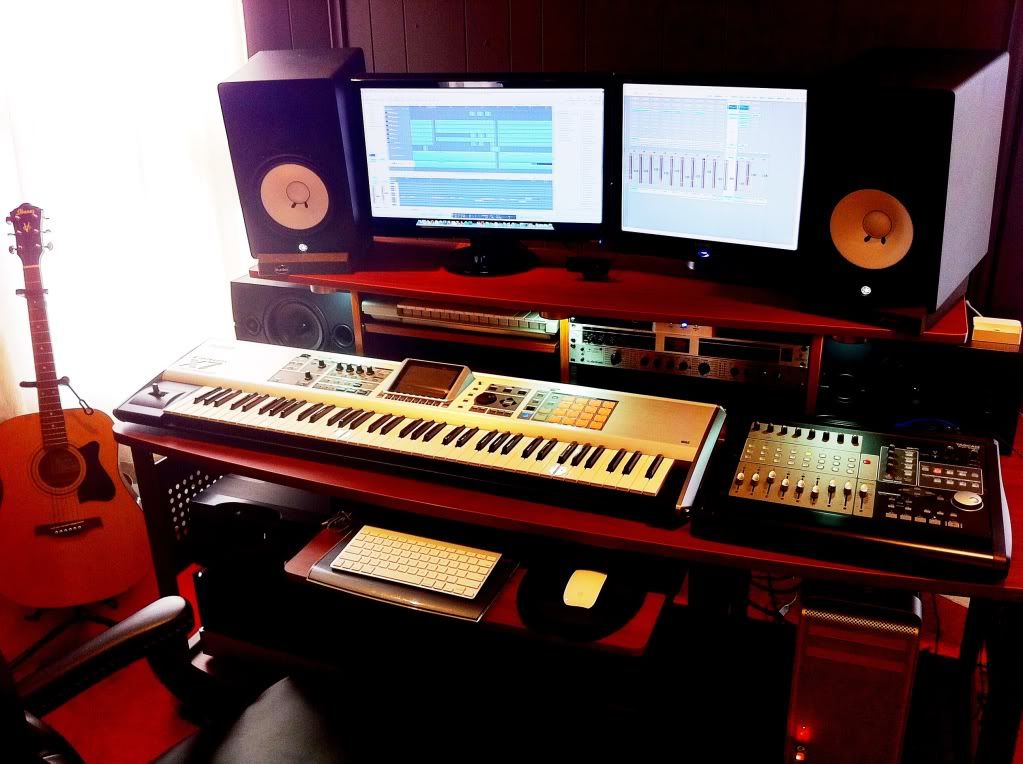

I probably should have gave the speaker measurements and specs in there as well
also...the windows have been sealed off with foam and sheet rock with a curtain over top to block outside traffic and dogs. uggg
I am using Yamaha HS80Ms on a studio RTA desk with Auralex MOPADs utilizing the 8 degree downward angle wedges to position the speakers more towards my ear.
The measurements of the speakers are:
38" apart from each inside bottom corner of the speakers
46" apart from the back inside corners of the speakers (to give ya the sense of angle towards my listening position)
41 high (measured from floor to the bottom of the front of the speakers)
55" away from the left and right wall to the front corner of each speakers
18" away from the back way to the bottom outside corners of each speakers
here is a picture of the set up as well...
anything needed let me know. THanks !
