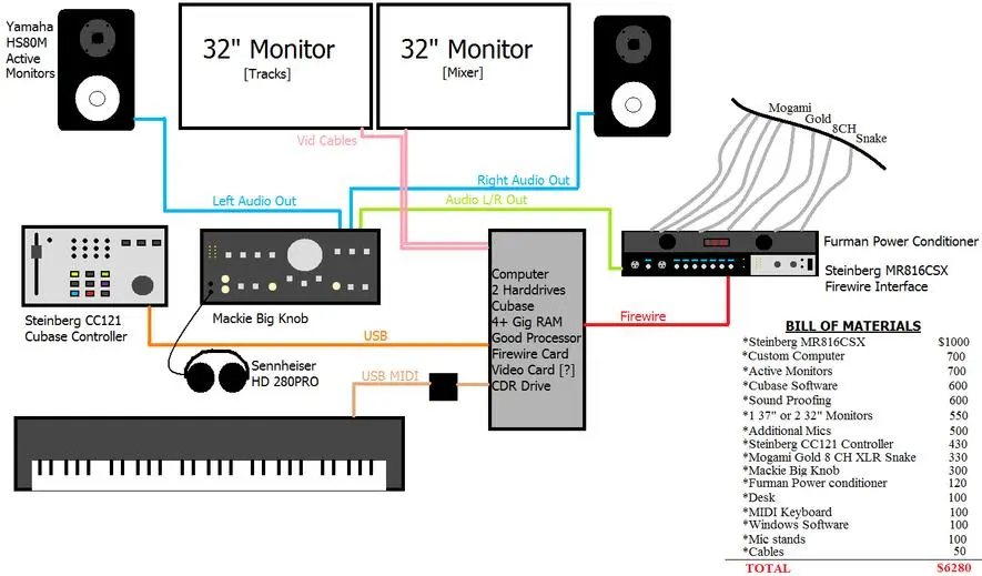

After doing a bit of reading and reading a lot of reviews, this is my current idea for my studio to be. I don't plan on buying any of the gear until I'm 100% set on the setup I want in the end, so I dont waste money on the way there.
My needs:
*Computer based
*8CH interface minimum, and expandable with quality preamps
*simpler, the better
*Going for a "mixerless" setup...
Not sure on:
*computer monitors: I am unsure if 2 computer monitors would be better than 1 large one? I was figuring, 1 could have the mixer and then the other could display the tracks only..? What are some thoughts on this? and is 37" or 2- 32" monitors overdoing it?
*MIDI keyboard or workstation? not really sure how midi works as far as integrating into DAW software, and what are good keyboards. What are pros to having the $1000+ keyboards honestly over $100 midi controller?
Any insight is appreciated!
Thanks!

) SO, that also will play into how much RAM you need. However, if you are running a 64 bit system, I would go no less than 8. Once you start mixing alot of tracks, adding effects and running plugs, it will start hitting your system hard.
