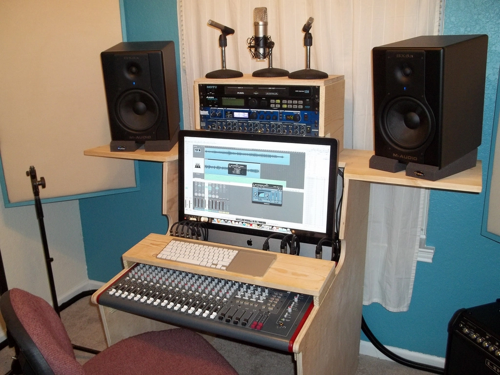

I built this desk specifically fit my AH ZED R16 console. For the initial design I made very certain that the monitor shelf had the monitors exactly where I needed and wanted them to be but I found my iMac screen was then a bit too high and was physically uncomfortable - always looking slightly upward and also constantly up and down between the screen and the console. It really for a disjointed recording experience. So I redesigned the desk midstream and put a shelf in right behind the console and the screen is now directly behind the mixer and man, oh man, does it work perfectly.
I think this may be what the MoBettaBlues is talking about?
