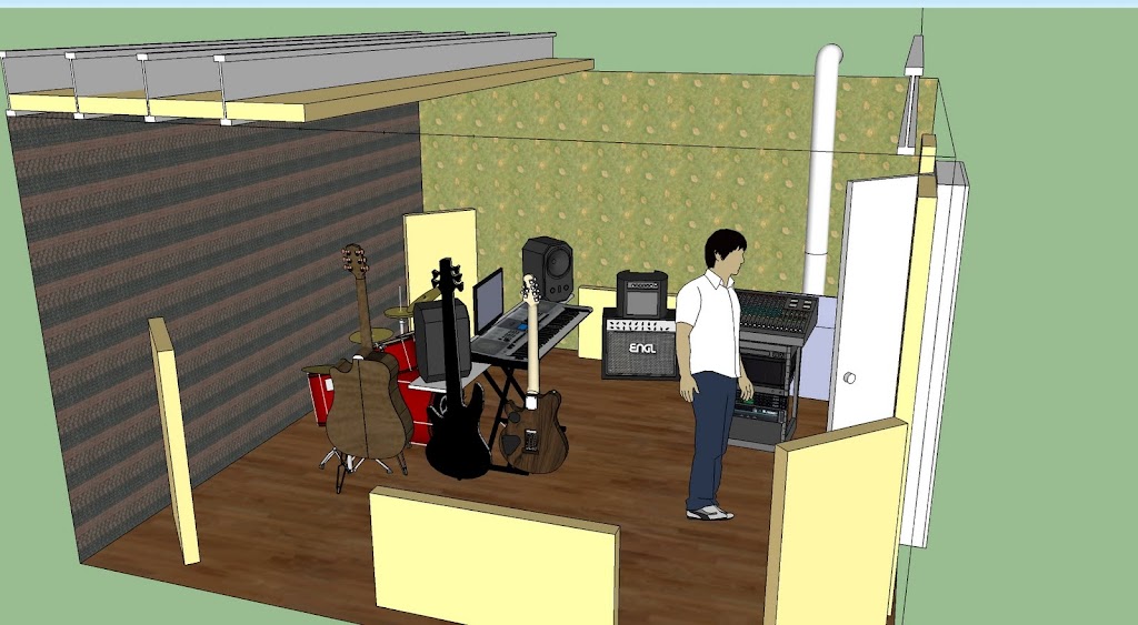

Here is what it is supposed to look like when done -
