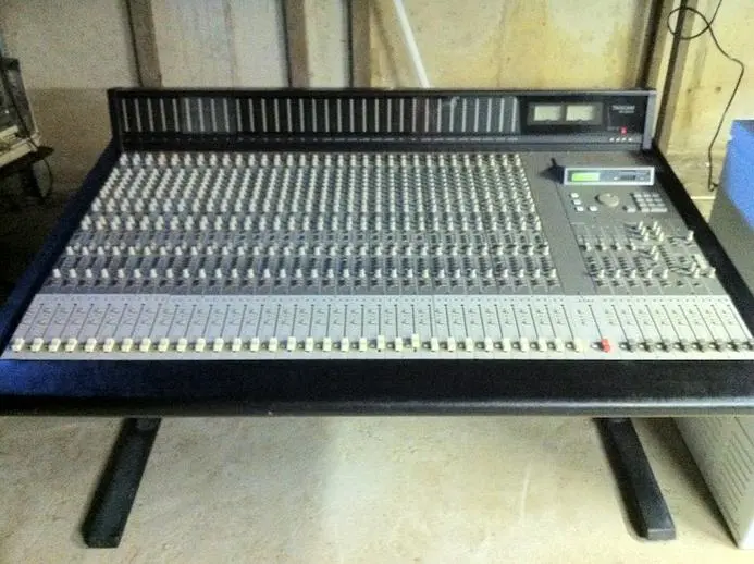

First up is the whole console in it's glory.

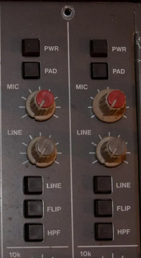

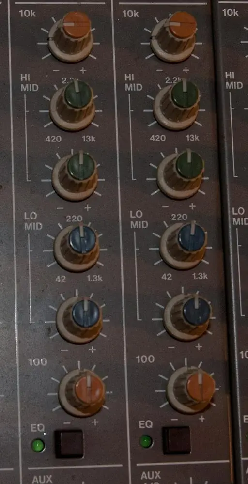

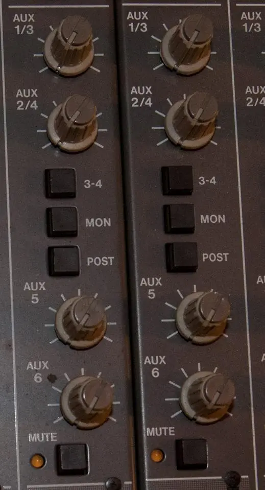

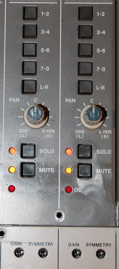

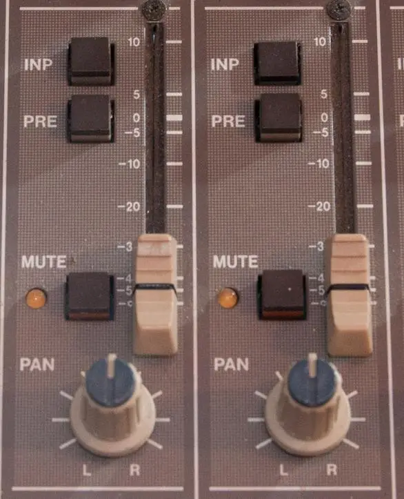

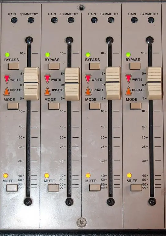

You can see screw holes missing their screws here. The board has a strip of alluminum that tells you what each channel number is as well as covering up the calibration knobs for the VCAs. I left it off so you could see the hidden pots in there. Eagle eye'd viewer will notice that the channel has a Mute button below the Solo button as well as at the base of each fader. The Mute near the Solo button is a standard latching mute identical to the M3500 (and any other console frankly). The lower mute is a soft button that is automatable. With the exception of the Mute below the Solo button all the other mutes on each channel are soft non latching automatable buttons as is the EQ in button.

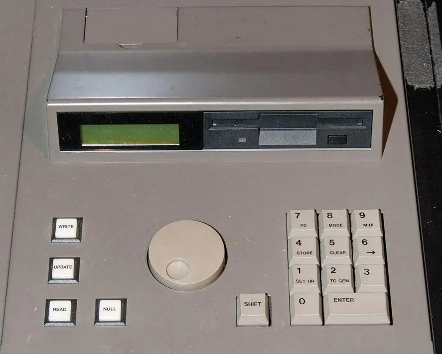

Automation: Tascam_M3700_Automation.jpg

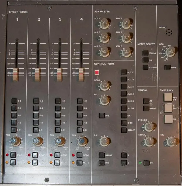

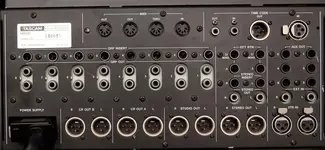

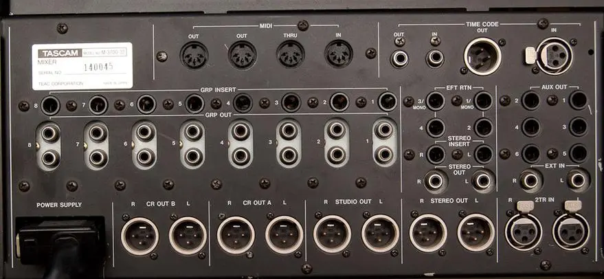

Then of course the connectors along the back:
You can see some of the DB25 connectors as a result of the balancing kit installed.

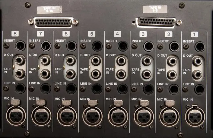

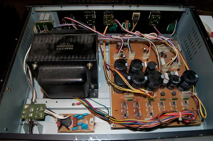

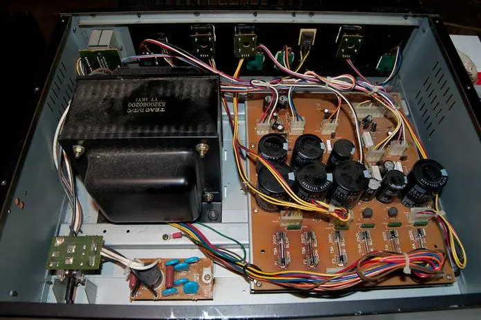

This is the inside of the Power Supply
Ghost, let me know if you'd like higher res versions. It's hard to get even light at night in a basement! Once the console is in tip top shape and installed in the studio I'll spend some time making some beauty shots.
Yep, that's a very familiar sight alright! Mine looks just like it except my armrest is gray and yours seems to be missing the label strip...what a steal you got, the 200 bucks was worth the stand alone, or the upgraded ICs, and less than the balancing kit (of which I'm particularly jealous...the unbalanced outputs are really killing the romance with mine)...looks great! I read that you can just run the knobs through the dishwasher (wish I had one!). I'll be curious to see if the JL Cooper auto is worth getting going...it would be nice to see exact fader positions, although if it doesn't work out, at least the standard auto has arrows that light up to show you when the VCAs are higher, lower, or null to the physical fader position.
Did someone really cut 9dBs of high shelf?? :D
Yeah, a high res of the first shot would be cool! :)
send it to; jeffpeletz "at" sympatico.ca
I should be able to work with that one as nothing is cut off. If you have others at different angles of the full board with no cut off corners, feel free to send those too!
Cheers! :)
On it's way Ghost.
Briank, everyone is cutting 9db of high shelf these days, get with it! :) I've not even run audio through it so if someone did or if it's just been turned during all the moving.. we'll never know. Perhaps they were going for the underwater sound-scape...

Funny you should mention the balancing kit Tim. I don't see a huge need for it at the moment. It has I/O on DB25 for 16 'Tape In' and the 'Group Outs' twice. I understand the reasons for the I/O it supports but I'm not especially hung up on keeping everything balanced. Once the audio enters the board it's no longer balanced anyway... If I had a 16 track tape machine with only balanced I/O I would certainly wire it up but I plan to use a Motu 24IO, which supports both -10 and +4 as well as my TSR8, which isn't balanced. I was pretty surprised to see it on the board though!
The seller said that even with the kit installed he still preferred to use the Direct Outs for recording, which are -10 RCA jacks. He said the audio coming through the Group outs, balanced and unbalanced, sounded appreciably different. I've yet to get any audio through the desk so I can't confirm but logically it should be different since it's going through the bussing system, ect. If I'll hear a difference, I don't know.

The Automation side of the board seems to be working well. I don't have it sync'd to any TC yet but in snapshot mode I'm able to save and load snapshots and things turn on and off as expected. Pretty cool. I found a 3.5" floppy disk in one of the binders labeled 'M3700 Pro Software B/up' so I'm trying to pull the data off of it and test it out. Oddly enough someone recently gave me a USB floppy drive for the Mac platform so it's a matter of getting a machine setup running a 'classic' OS and seeing what's what. Fingers crossed! The documentation mentions nothing about which old Mac OS's are supported. The feature I'm most interested in is the ability to load and save automation data to the computer, instead of on 3.5" floppy. Making backups of files from a computer is a lot easier then trying to keep a stack of floppy disks in good working order...
