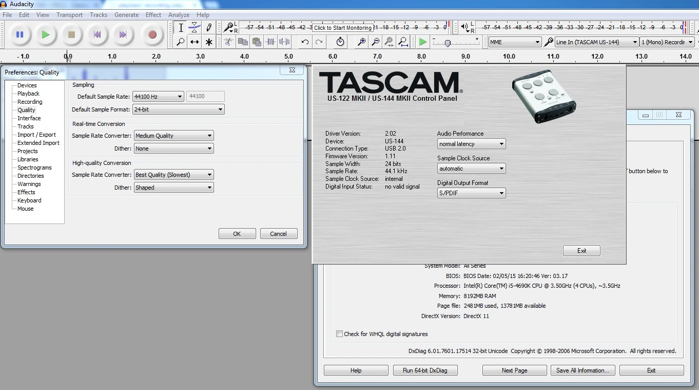

I am recording using a TASCAM US-144 audio interface and a microphone.
Audacity software (also tested windows recording, same result).
I've been searching around and people are saying this is caused by frequency miss matches however
I don't think my computer specs are an issue but i included it anyways.
Everytime i record the playback is super fast and chipmunky and also on occasion it just skips some of the recorded time (like it stops recording for a second or 2 then continues)
Nothing I have found online has helped so far :(

See, SOMETHING is switching the sample rate despite what the pickies say.
Then it might be best to clean out all the Tascam software and re-install and IIRC the 144 has a funny setup protocol? Connect> run drivers>disconnect>reconnect> run some more? The AI should have come with Cubase, beats Audacity for general home recording. If no Cubase try Reaper or my fave for a simple, free DAW, Magix Samplitude Pro X Silver.

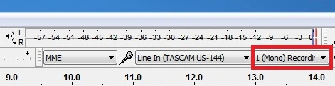

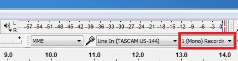

Try changing that setting from Mono Recording to Stereo Recording.

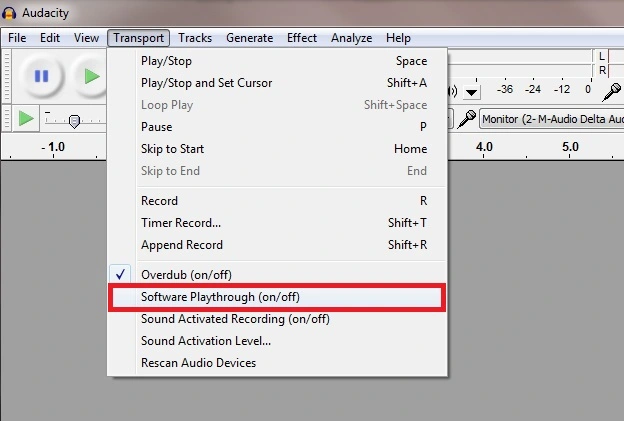

Also, check if Software Playthrough checked in the Transport Menu? If it is, un-check it.
