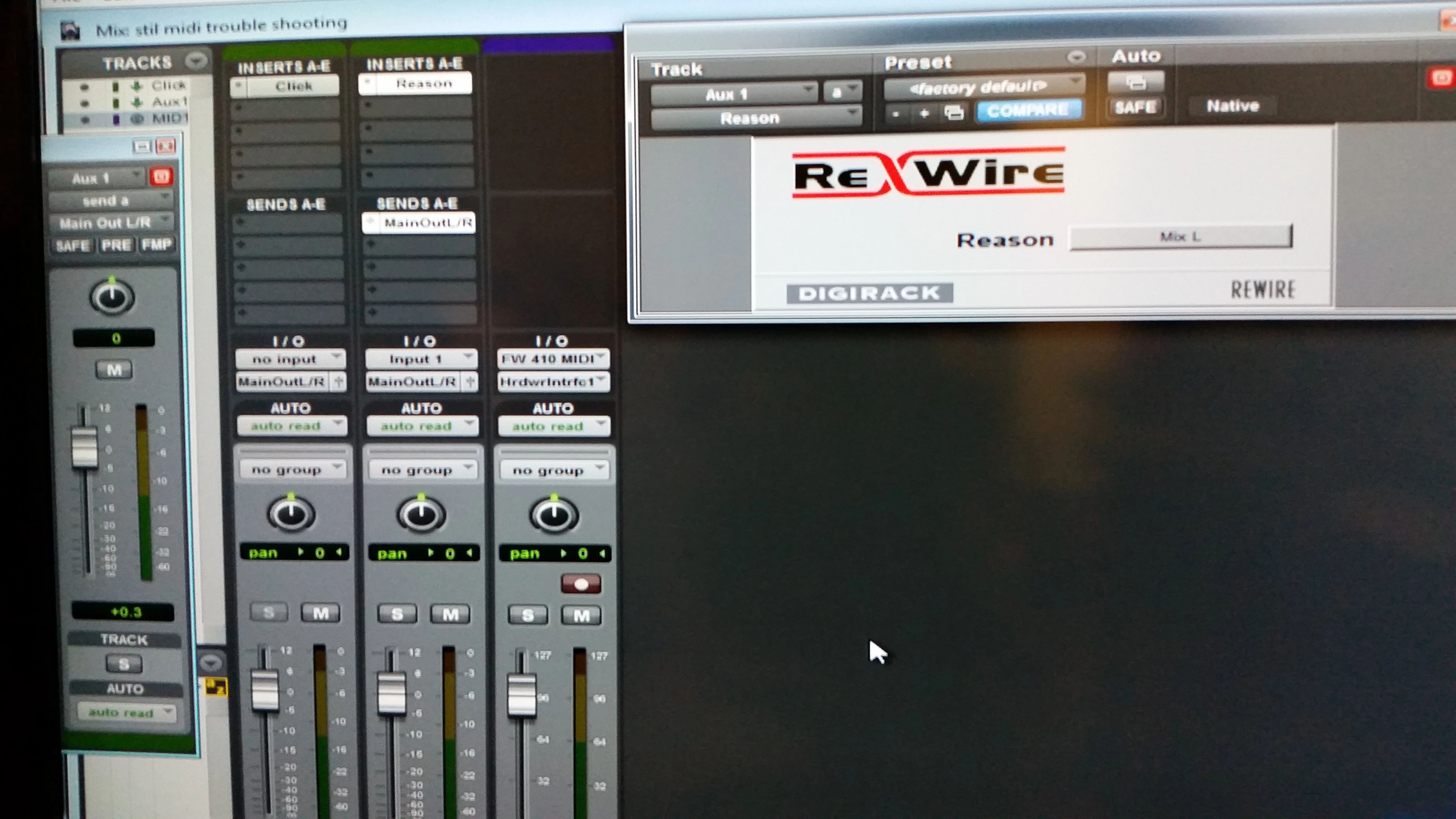

Hopefully this picture attached...this is what my mix window looks like. I have tried diff variations of the I/O's and I am still getting midi recording with no playback. In previous sessions, I have tried to use an Instrument Track for midi, but tried a Midi track this time, as guitargodgt suggested. Can anyone spot what I'm doing wrong?
In this picture the output of your midi track is not set to NN-XT (it's hooked up to hardware interface). This is your issue.
In other words, you need to tell your midi track where to go.
The reason you can hear Reason when you record is because you are connected to reason inside reason, but you are not connected through pro tools.
