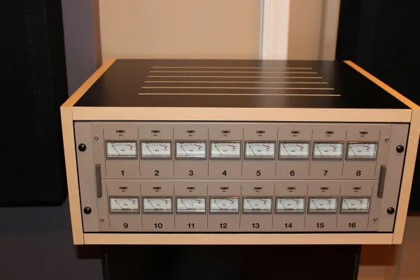

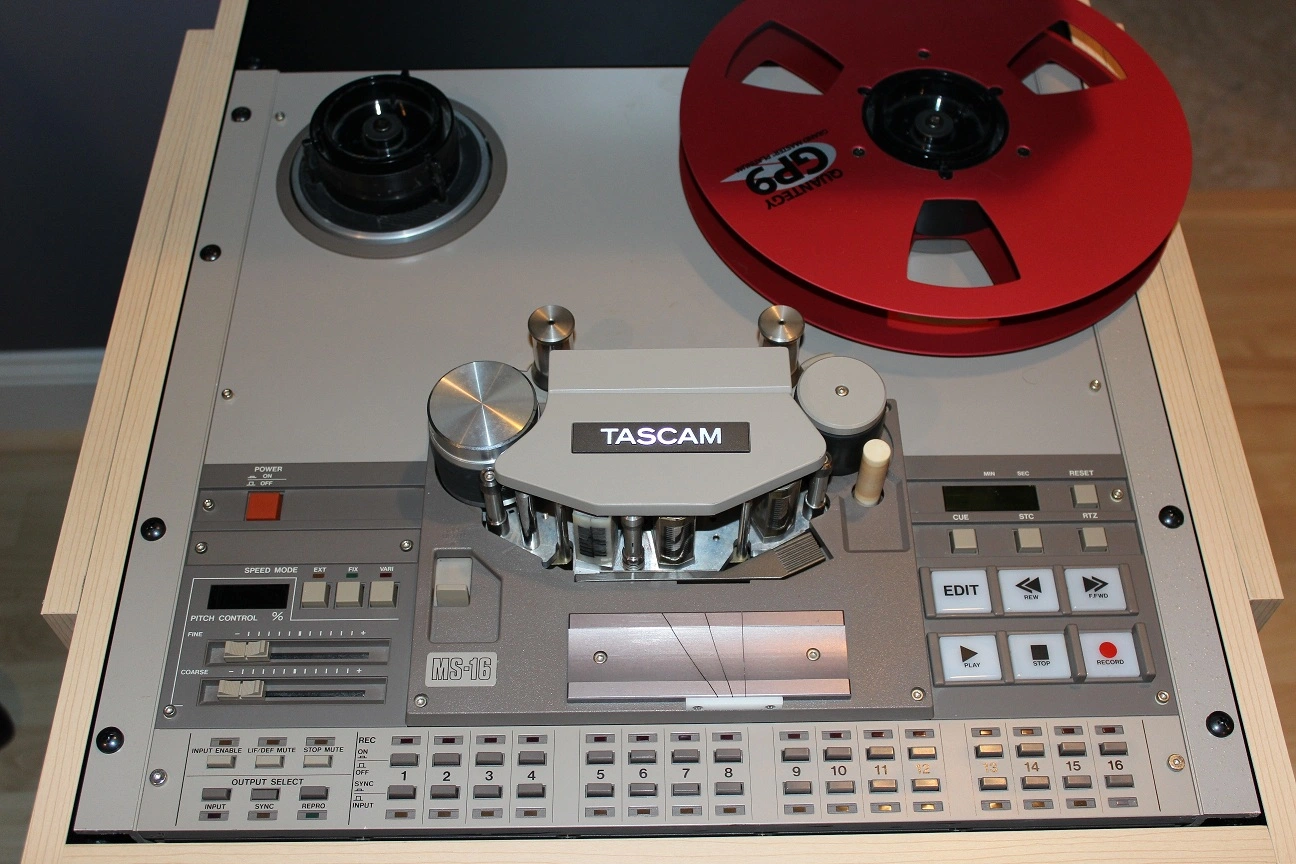

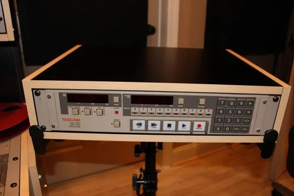

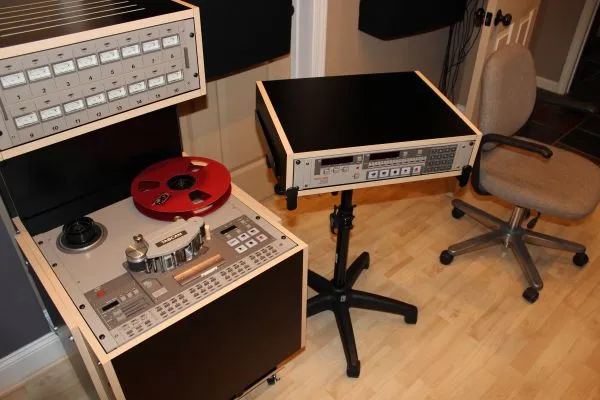

Looks clean, heads will tell the whole story, if you do a visit, just play the MRLS and see how good the playback is. Not a total indication, but it can help assess. Pay special attention to the high frequencies. One other good indicator is that the buttons are not worn. The little black signs on them usually wear out pretty fast, both on the locator and the machine.
