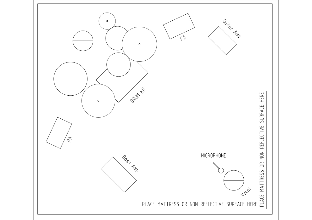

Thanks for all the good tips guys, I will rent a louder PA just to compare with, and get a EQ to ring out the room. The nasty feedback always seem to be in the 2.2 Khz and 5 Khz.
also we are not ready for gigs, what we want is having fun without that annoying feedback, we've been having this problem for one 1 year now, sometime we are lucky I am able to pinpoint the best EQ settings (3 bands settings) but sometime, everything I try just doesn't work. (Its like it depend of the weather outside) hahahah.
Thanks again
Generally speaking you'll have better luck addressing actual acoustic issues first, such as source volume, instrument volume, absorption/diffusion treatment, mic placement etc. Electronic solutions are the secondary layer of defense, much less effective. One reason is that any small change can shift the problem frequency making your eq cuts ineffective.
