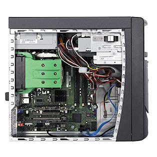

Hello everyone. Here's my story. I recently purchased a new computer and upon receiving it realized that the pci slot for the soundcard will no longer work with my soundcard because the card is too big for the slot. SO...I'm looking into an alternative solution to doing recording, as I customized the computer with all the crap I would need to do high speed recording (i.e. gig of ram, pentium 4 3-gig processor, 250GB hard drive etc.)
Here are my needs/what I would hope to accomplish:
*Be able to multitrack up to 4 (or more) tracks on seperate tracks in Adobe Audition
*Need phantom power to power condensors
*Don't necessarily need line inputs as I don't do much direct but would like the option
*Needs to externally hook into the computer as most pci slots are unavailable
*24-bit/96kHz processing
*Need Mic pre's or otherwise ability to run from mixer into the unit, however the former is the preferred option.
*Ability to monitor input as well as output from the computer for mixing purposes through headphones and in the future, monitor speakers
*Willing to spend between $200 - $400
*I'm running Windows XP and Adobe Audition 1.5
I'm currently looking at the Lexicon Omega as my primary option but I was wondering if anyone had any input on the subject as to how well this product performs or of any superior alternatives. I'm willing to entertain any options within reason. Any and all help, suggestions and comments are GREATLY appreciated. Thanks in advance.

The pci slot is too small for the soundcard to fit. Thus I can't use a regular soundcard to record. It's a Dell Dimension 4700c desktop. The card is built into the tower. Hope that makes more sense. Guess I should proofread these things huh? :p
you have pci express slots, they are smaller than regular pci
Thanks, I had no idea what they were called. Do they make cards that will fit them? or should I continue on the USB path? Or even which would be easier? Thanks

The specs for the 4700 clearly state it has:
2 PCI slots
1 PCIe x 1 slot
1 PCIe x 16 (graphics) slot
http://www1.us.dell.com/content/pro...c=us&cs=19&l=en&s=dhs&~lt=popup&~tab=specstab
The 1010LT is a PCI card as well:
It don't see how it couldn't work with your Dell.
so you've used the other two pci slots?
if you have a firewire I/O that would be your best option. I've got an Edirol FA-101 that serves me well.
I'm using the 4700c not the 4700 which I checked the specs and it has:
1 half-height PCIe x 1 slot
1 half-height PCIe x 16 (graphics) slot
There's the problem. So I'm really concerned with USB supported devices as I can't support firewire either.
