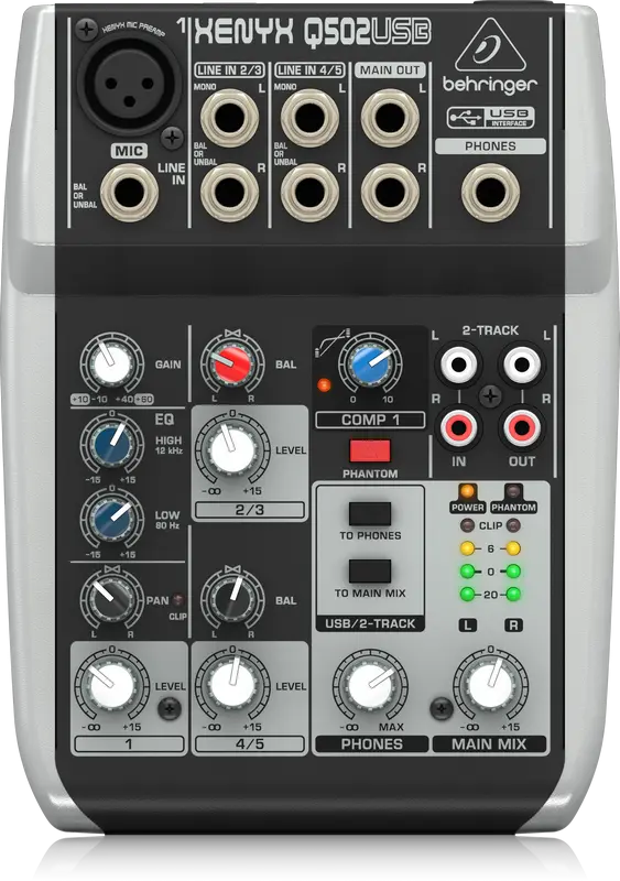

I don't think you'll find a mixer that takes input from USB wireless mics like the ones you've got. Using the 3.5mm outputs might be your best bet. I wonder if you could power the receiver/USB units from a couple of USB power supplies (like phone chargers), then connect the line outs to something like the mixer in the link below, which would then connect to the computer by its own USB. As a bonus you would get a single XLR input for a proper wired mic.
Q502USB | Analog | Mixers | Behringer | Categories | Music Tribe - Behringer
You will need 3.5mm (1/8") to 6.35 (1/4") cables. There could be a little challenge here as you're interfacing what may be either stereo or mono wiring to what's probably balanced wiring. I suspect the most likely cable to work would be a mono/unbalanced cable with TS (tip/sleeve, with only one plastic ring separating two metal contacts) on both ends. Using a stereo/balanced TRS (tip, ring, sleeve, with two plastic rings separating three metal contacts) would give you problems. Stereo and balanced use the same TRS connector (which can be 3.5mm or 6.35mm) but do different and incompatible things. Using TS cabling defeats both and gives the best chance of working. I know this may seem like information overload (which I suspect you're already experiencing), but I suspect getting an audio pro there in person isn't really an option right now.

For what you want to do, the USB mixer sounds like the right approach. Plug your lavalier line level outputs into it. USB connection to the laptop. I think you be able to run the PA from the mixer then the teleconference app can go from the PC into the mixer. The mixer should show up as an audio device that is selectable in the app.

With the mixer in BSG's link, you won't need an XLR connector. You can go 3.5mm to 1/4TRS.

Yes, you can use that simple cable to connect the receiver to the mixer. If you need to provide power to the mic receivers, you can probably use USB power supplies.

Yes on the cable. I linked to a simple mixer above.
i - sorry - im not sure what BSG is - but are you saying a simple 3.5mm to 1/4inch lead will let me take the line outs from the USB mic recievers into a mixer? if so great - im just hoping someone will post a link to suitable mixer. i really dont want to pick one myself as it looks terribly complex and im generally quite a technical minded person!
so on this device Q502USB - there are lots of inputs! the 1/4 inch ones look like they are split L and R - but id only have one 1/4 for each of the two mics. Can anyone tel me how id link this up?Q502USB_P0ALL_Top_L.png
