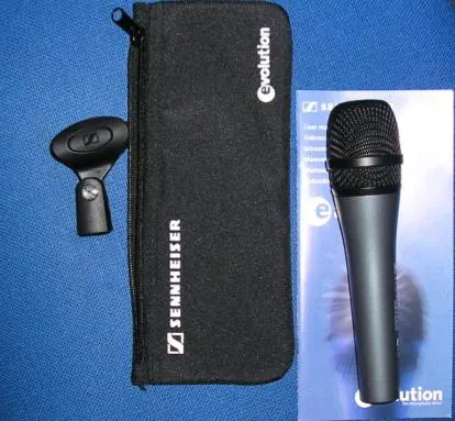

Hey guys I have a problem
I've just got a microphone (Sennheiser 855) the same one as Linda have
I want to connect it to my pc, but I'm affraid I can't do it with the stuff I got (check the photo out)
Can someone help me and tell me which connector (or other things) I need ?

I was finally sent the cabel, but I need a reduction jack 3.5 to my computer
My question is do I have to have 3.5 MONO jack for a Sennheiser 855?
I asked my mom to buy me a jack but they had only 3.5 stereo and our friend told her not to buy it if it's for a microphone. Is it true that I need 3.5 mono ? :confused:
Thanx in advance

All microphones are mono unless they are specifically labeled stereo (and there aren't all that many stereo mics out there). Your 855 is mono. Pretty much all the mics discussed on this board are mono.
So you understand the difference - mono means one, stereo means two. A stereo mic actually has two seperate microphones that pick up two different signals. Here are some examples of stereo mics:
AKG C426B
Shure VP88
Rode NT4
There are a handful of others out there, but not a whole lot. Some cheap ones have been coming out recently for business conferences and live recording, but for the most part, they're more expensive than a typical mono dynamic like you have.
To further understand the idea of mono vs. stereo, cover up one ear. Walk around - listen to how things sound (this isn't perfect mono since you can't perfectly cover you ear - but you'll get the idea). With both ears uncovered, you hear in stereo.
And if you haven't already, read the big sticky thread at the top of the forum.
-Peter
