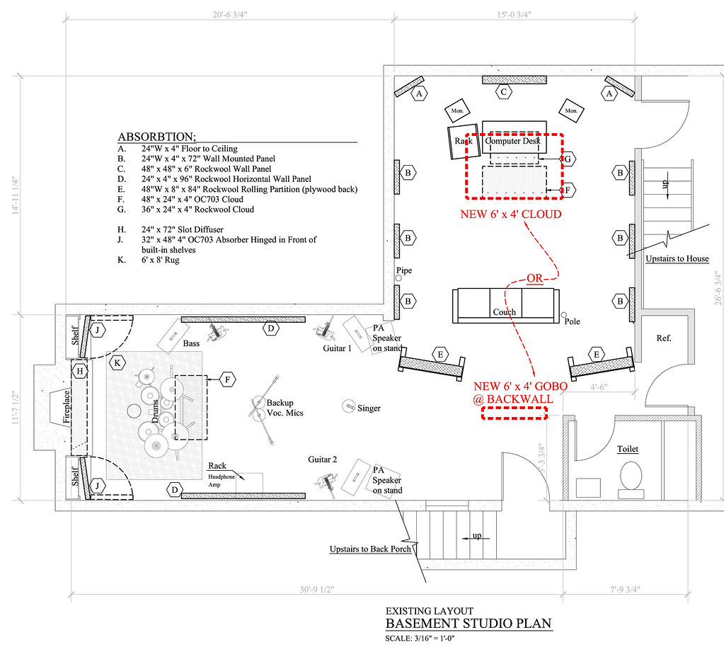

quick question... I have 3 and a half pieces of 4" 703 left from my last project. At first I thought a new cloud over my mix position would be good, since what is there now is kind small- its 3" rockwool mounted on a plywood backing. So, I figured a thin metal or wood frame with the 703 wrapped in fabric and set inside would be good. The new cloud would be 6' x 4'.
...then I though, well maybe more absorption at the back of the room would be good... Unfortunately I don't really have a symetrical back wall to treat. I've never really been sure what to do with that. I already have two 4'wide x 6'+ tall gobos back there on wheels. So, would another be more valuable than a new mix position cloud???
This picture shows the two clouds (white) that I'd replace with a new big cloud.
Or, should I do both? I can get more 703 if need be. (or neither? you gotta better idea?)

It is hard to say, but in my opinion the cloud you currently have is too small to be of much use. I would put the larger cloud over your mix position and retire the other clouds to behind you.
I have quite I bit more absorption in my mix area than you and it is not dead at all.
Thanks Tom. I kinda figured my current cloud wasn't up to snuff. It was really kinda made out of extras that I had after I did the walls. I moved some stuff from my old house (first 'studio'). I can actually probably make the new one 7'+ by 4'.
As far as being too dead, I'm sure my mix area isn't even close to too dead :p. I do like a live drum sound though, and my last project added absorption back around the drums.
I like a livlier room for drums too.
I have stained concrete floors which help add some reflections, and I have removable wall absorbers for when I want to create a live....er... sound.
I actually hung electrical conduit on the walls and put hooks on my panels so I can move them around,
The hooks on the panels also allow them to be hooked onto a microphone fixed boom when set horizontal so I can use them as gobos.

I think you should use the 4'x4' panel behind your monitors as a cloud and move the clouds you are using now to directly behind each monitor. Then make a 6'x4' gobo panel for the back wall.
I also feel the your side wall absorbers aren't quite in the FRP and are therefore less effective than they could be.

YES! I like what your doing, gears turning etc. Cool photo, Awesome drawing!
Hey, make up your panels, place them in the locations you are thinking about, with temporary mounting. Try it on in one spot for bit, move em, and taste again.

Hey PM- thanks for the feedback. Switching the 4'x4' on the front wall with the current cloud will result in pretty much the same size cloud. Plus the two pieces that make the cloud now aren't even the same size so I think they'd require some rework (rofl- like I said they were made from spare parts).
Since I made that plan, I have moved the desk and monitors a little further back in the room, and as a result I think the frp aligns a little better (but not perfectly) on the first 2'x6' panel on the side walls. Unfortunately I didn't have a lot of options for where to put the doors when I built that right side wall, and I opted to leave myself some room to get a corner trap in that corner instead of pushing the door all the way to the corner.
So, I'm thinking with the 3+ pieces I have now, new bigger cloud. Then get another case (which is 6 pieces) and do the back wall gobo. I might even go 6ft. wide by 6ft tall with that, since thats about how much room I have between the 2 gobos back there now in the configuration of this drawing anyway.
Then with the spare pieces, I can do something directly behind the monitors. Maybe I'll eventually double up that first sidewall panel, but the trouble will be that half of it will be over teh door opening- so either panels on the door or something hinged on the wall to swing in front of the door. idk...

Thanks Scott. I draw for a living- mostly commercial and industrial stuff- I'm not licensed yet, but I have a degree in architecture. :)
Sometimes I feel like my 'studio' is all function and no form, lol. It definitely isn't as pretty as some of the others around here, but I'm getting close to having it sound as good. :p Someday, I'll spend money on drywall and flooring, but for now I have to make due with an unfinished look. I'm putting my $ into better sound. :)
For the cloud, I was planning on one big 4ft x 7ft.+ frame faced with fabric (duck cloth comes in 5' wide rolls). So, once I build that, finding another location would be tough.
I will say that those 2 back gobos move around ALOT depending on what I'm doing. For normal band practice, I'll spin em to face the band area. When I'm mixing, I'll rotate them similar to the plan above, but usually I have them butted side by side instead of spread out. When we do vocals or other indivdual instruments, they get rotated so they kind make a 90 degree angle tucked in the corner between the sidewall of the bathroom and the back door.
Hey Jeff,heres my .02 Use the piece for a new cloud.

I've pretty much decided that I need a new cloud more than anything else at the moment... so, now I'm focusing on how to build it. I have (3) full 2x4 pieces and (1) ~1x4ft piece. So, I'm thinking, might as well use it all for the cloud.
The easy thing to do would be to build a 7ft by 4ft frame out of 1x4 boards, stretch fabric over the face and use a bracket to screw it tight to the underside of the ceiling joists.
But, I saw a picture on another site (that I can't find right now :mad:) where the guy used what looked like drip edge (like for along the edge of your roof, lol) and made a frame, hung that and then just set his 703 pieces already wrapped into the frame... which means the sides of the absorber are then all exposed for additional absorption. I think if I go this route I'd use ceiling grid or a light gage stock angle or something instead of drip edge, lol. I like to use duck cloth for my stuff, which is like a light canvas (60" wide too) and i think would be a little harder to get crisp corners when wrapping a bare piece of fiberglass, which means the wood frame would make upholstering easier... I dunno...

A wider cloud will improve your image and probably something "a bit" in the response too (you don´t talked about frequency response of mixing room, it´s allright?)
Nice space you have, good luck!
Frequency response is workable IMO, but I'm sure its not perfect. It was obvious when installed the current treatments that they made a big difference. Low end is still a little hard to distinguish. My mixes definitely translate better to the real world than they did in my untreated space.
To be honest, the math of calculating RT60 and frequency and modes, etc, especially for my L shaped room is a bit beyond me, and I don't have the gear to measure it- though maybe picking up a measuring mic and some kind of software would be a worthwhile investment, that I way I can quantify some of this stuff.
I do think improving the imaging will help tremendously. (I hope, lol) I certainly don't think it will hurt.
