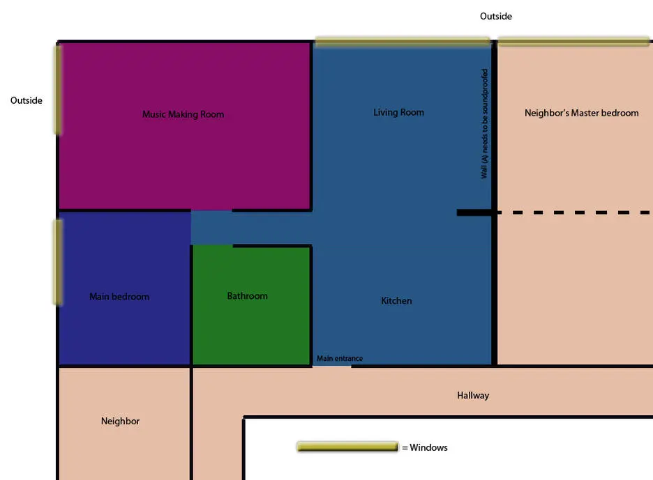

Here is a drawing of what the apartment I just moved in looks like, I chose this one in particular because of many reasons, but the most important one being that I intend to make music (jams, record music, mixing projects) and the room that will serve this purpose in not adjacent to any neighbors, downstairs being a business closed on evenings and the outside world + other apartment rooms on other sides.
The living room and kitchen are one big room only separated by a little corner.
I also intend to throw the occasional party in the living room and enjoy movies with considerate volume and don't want to disturb the neighbors at night so I will be covering the music room and living room with acoustic panels to attenuate echos and unwanted reverberation, I'm hoping this will help reduce volume in the apartment.
After reading a lot about soundproofing, I realize this will not be enough so I'm considering soundproofing the living room wall (Wall (A)) that is adjacent to the neighbor's master bedroom. The windows in the living room extend all the way from one wall to the other, so I only have about 3/4 of an inch that I can use to add mass to the wall before getting onto the windows' frames. I also cannot open the wall and place mineral wool or fiberglass in between the wall studs so I'm hoping there's already something there to help with that.

Hello all ! I'm new to the world of soundproofing, I spent a lot of days on forum research before posting here and now I just need to cover specifics.
