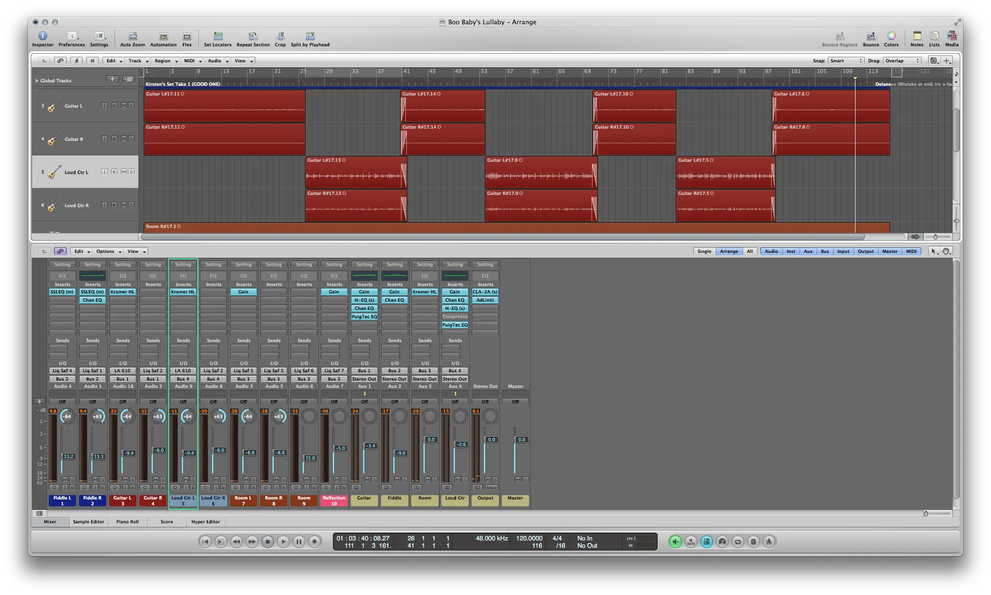

This is a screenshot showing the waveforms of the guitar parts.
Definitely didn't clip, it's the compression you can hear (Thus me starting this thread, how do I get it to sound harsh without the compressor making it sound distorted?)
