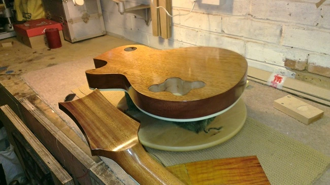

Pictures don't really show it but the after shooting a sealer coat it's really flat and bright. In case you are wondering how I avoid getting overspray in the control cavities I fill them with sponge and lay paper on top of the sponge which is changed with each lay up...;) The front has a wash coat of shellac on it to protect it but tomorrow it will get a sealer coat. After that nothing more until I have the thing together and the final routes and holes drilled.

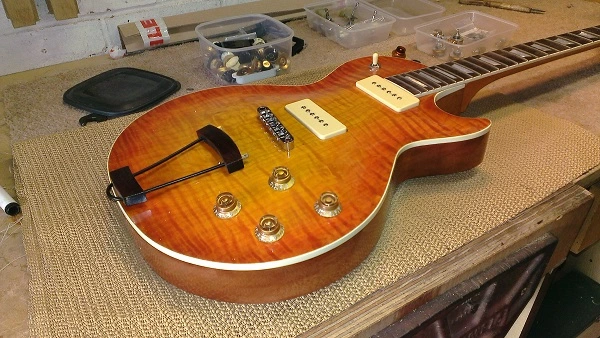

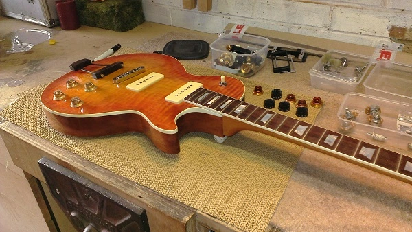

Anyhoo, I had the thing loaded up with polish and it needed to sit for a while. I shot nitro on the body back and sides and have the neck done in tru oil cos thats the feel I like. The top I decided to do a french polish shellac style on because I wanted to test out the z-poxy filler on as many finishes as I could. All seems to have gone well and I learned a bit from it.. The final cut and buff will be when its just about done but the thing shines quite well so far... Hard to capture shine on a phone camera.
Her it is with the fittings starting to go on as I work through drilling all the body holes and preparing for the neck to be glued on. After that it's assembly and setup. Should have it done soon as long as other people don'r need stuff done in the meantime..
