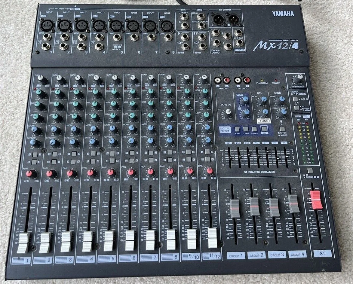

I have an old Yamaha MX12/4 that I use. I run the main outs to the QSC amp, and send the vocals to subchannel 4 and that fader doesn't get moved. It feeds to the Zoom R24 for the vocal feed. Works great. It was introduced in 96, and is still working perfectly. You can pick them up for about $200. Wish I had it 40 years ago.
