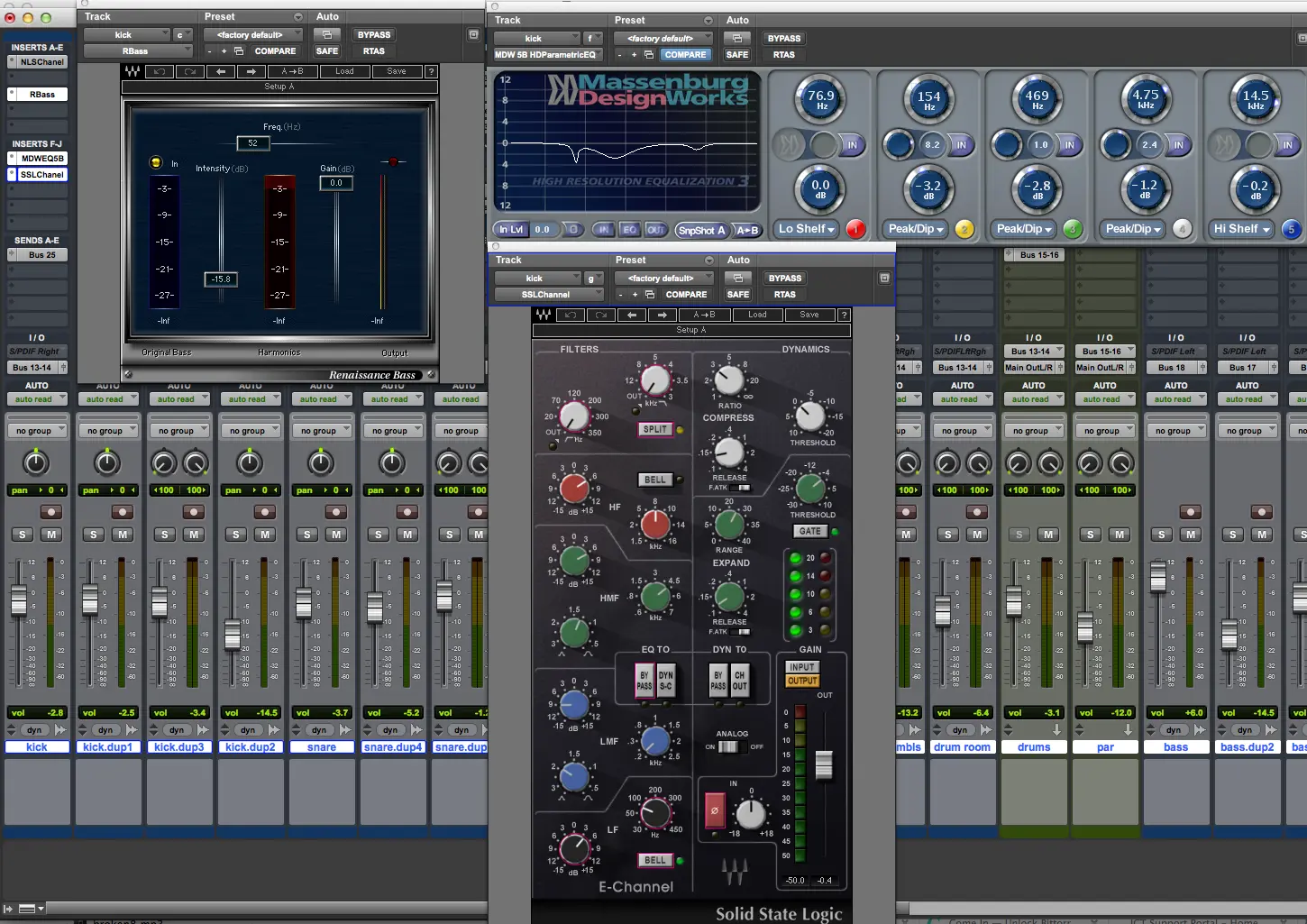

My Kick is not a simple preset, its a mixture of sample and kick. I can say you need the NS10s or similar speaker to gauge the top of the kick. I used SSL eq from waves to get it there, rbass to kick more oomph

Kick is split into 3 tracks this is what I did on the main kick, their is a trigger and an Attack track (essentially a high passed version of this kick blended in to give a bit more attack)
Listen to "my demons" by Starset... the mix shares the similar "hollow sound" you refer to but I admit there is a limitation from a production point of view.
Note compression is done on Trigger and Parallel bus (CLA76 on paralell with fast release slower attack)
