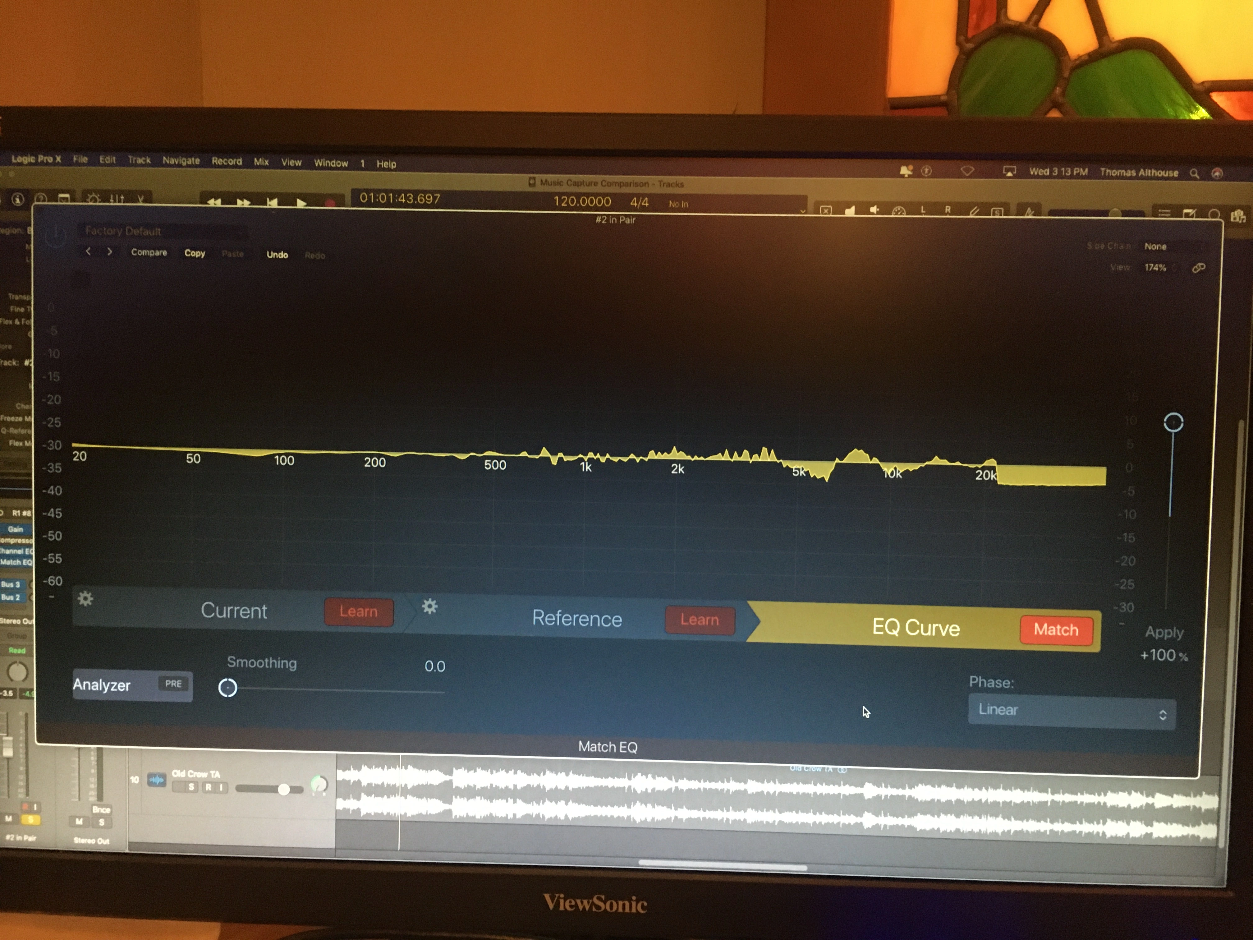

So for the experiment I took part of a mix that I am just working on, played it back in mono through my left monitor, and set up 2 microphones that are the same models but are not a "matched pair" about 1 meter in front of the monitor, at about tweeter height.
I played the mixed track back while recording it through both mics ( Cardioid pattern).
Then I used the mix track to capture the reference sample on Match EQ.
Then used it as a reference while sampling the microphone captures to then create a matched eq setting. I've bounced this result to compare in playback to the original mix. See One of pair matched to source track
I also took the first microphone and used it as the reference and "Match EQ'd" the second mic to it. It is attached as well. See attachment "#2 of pair Matched...."
For the original mix snippet in mono see attachment "Reference for pair...."
Levels for each mic were set roughly by just eye balling the input LED's on the assigned tracks, you can fine tune each to match if you want.
The mic's are the same model but I have no idea when each was made and it's path to me. They are not "Factory matched.'
The sample matching #2 mic to #1 has maximum smoothing applied and only 60% "correction applied in the option of the plugin.

I also set up 7 completely different microphones with a cheap measurement mic on 8 seperate tracks and did the same recording. Then I applied the cheap measurement mic as the reference for each to see how close they might sound as this would be the wildest combination that I could think of. Different manufactures, models, diaphragm sizes, LAD, SAC etc.

I think most will agree that Match EQ when applied with common sense can probably do as well as a factory matched pair? (#2 of pair matched to reference)
