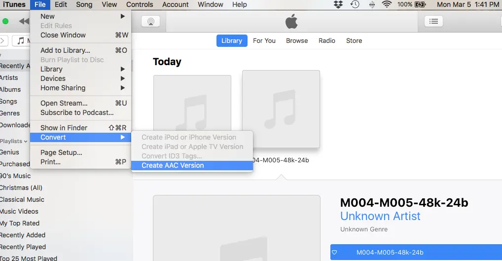

Logic Pro X ($199) is a bit rich for my pocket just for that functionality.

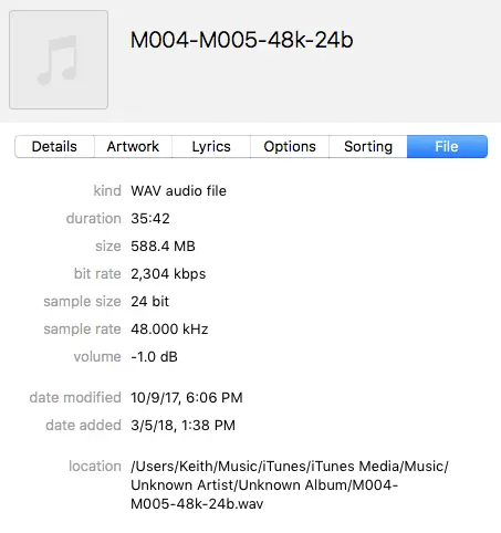

Why not save a wav (as an archival copy) and convert it into the desired output format? That's how I do all audio anyway.
Audacity will do it too. But you need to install lame. And you're using a strange combo, so you might need to make your own preset for export.

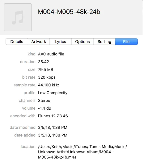

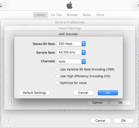

I did some testing between MP3 & AAC (M4A) and AAC was clearly better for me even when comparing a 320kbps MP3 against a 192kbps AAC. I know some people will say, just accept files at 192kbps but I would rather 320kb. Basically get the best quality I can from a well supported format short of going full lossless.
I don't understand that point. I've been producing AAC files but they are 192 instead of 320. That's not lossless.

It gets a bit confusing that the file is AAC but it uses a M4A extension that can be used by other file formats. All I know is I get a M4A extension.
M4A is a container. Like .avi, or .mkv. It can contain lots of different audio/video, encoded with lots of different codecs.
I don't understand that. Why can't it be increased to 320?
Like I wrote above, I think it tops out at 192 kbps for stereo. For 5.1 audio, it supports 320.
