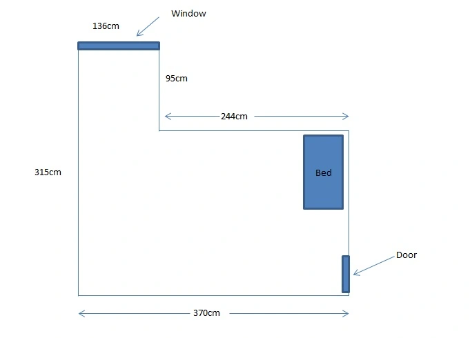

Hey guys,
Firstly thanks a lot for the replies on my previous enquiry.
For this room, where would you suggest my desk to be for monitoring/mixing purposes? Anything to take note for this particular room?
I know it's not ideal but i have no alternatives in my home anymore.
Thanks
This is not ideal, but I'd move the bed and put the speakers against the wall on the right facing toward the left. Pull your setup enough away from the right wall so you can get in and out through the door.
--Ethan
I agree with Ethan as well. As odd as the room might end up, it is the only choice that allows for symmetrical first reflections. The only other possible option I could see would be to face the wall on the bottom of the drawing. Perhaps you can try both and see which one gives the best sound?
