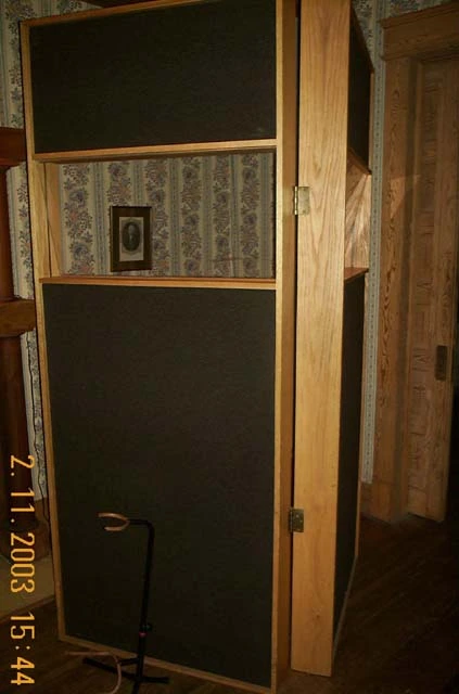

was poking around a studio on music row in nashville last week and saw these simple gobos. Liked the window idea.

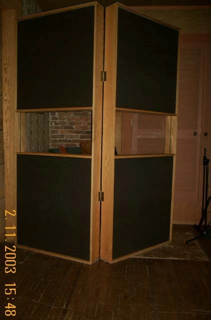

one more with lower windows

do you know what material they are using (other than the wood) for sound isolation. i see the dark grey but i can't tell if it's foam or fiber or what.

Okay, I have taken those pictures on the first reply of this thread into consideration. Scroll up and click on the link!! Anyways, since my two walls that I am making need to be transportable, because I am going to move them out of the way when not being used, I am thinking of using that idea. Except, I am going to run plexiglass in between the wood and the studio foam to allow for maximum sound isolation. So those windows will still have glass in them, but the glass will expand to the exact shape of the two walls!!
What do you think??
Chris
The dark stuff is cloth over what i thought to be about 1" fiberboard ( on each side of the gobo ). The whole unit was about 6" deep.
They obviously are not for total isolation, but if you're recording a whole band you can put a acoustic guitar behind one for some extra separation, and maybe a scratch vocal behind another one, ect..
