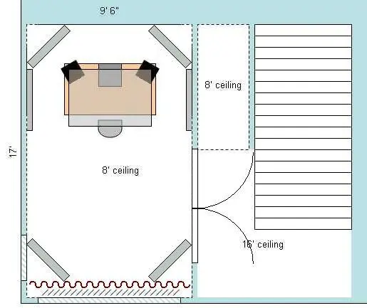

Here is the layout of the room in my house I currently use as "the music room":
After reading Ethan Winer's website and thinking about reflections and interference, I see I'm up against a number of challenges regarding the shape of the room (almost exactly the dreaded even multiple of LxWxH), the open wall, and the computer system and studio monitors (new KRK RP8's) shoved into the corner.
This is pretty much the only room I have for my hobby, so I'm stuck with what I got. Below is what I think I could do to the room to improve things a little (the grey rectangles on the wall and the translucent one on the ceiling are approximations of where I would put foam or something similar to stop the first reflections):
I have access to the bumpy black foam they use in the lids of Pelican cases. It is 1.5" thick about about $40 CDN per 60"x80" sheet. But I'm unsure of it's acoustic properties. I couldn't find any of the insulating materials noted on Mr. Winer's website at my local Home Depot.
My questions are:
1) Is 'acoustic foam' any different from the foam you often find in the lids of cases used to haul around electronic equipment? Do I just glue it to something thin and hang it on the wall like pictures?
2) Do I have much to worry about in the way of the large window with the vertical blinds or the large opening in the wall adjacent to it?
3) Where would I put bass traps in this room?
4) Is this room a nightmare and I should just resign myself and my band to the cold cold reality that if I do the mixes at home, they're going to sound like "I did this at home!" ?
