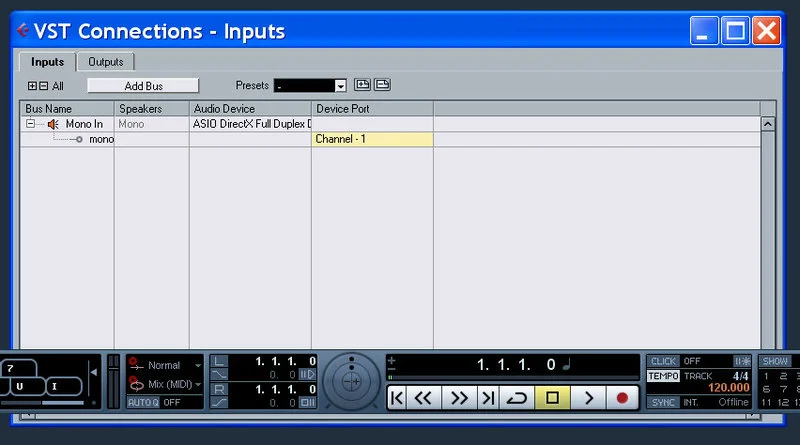

---Click on 'Inputs' tab. Select 'Add Bus'>dropdown menu to 'Mono'>Ok. You can name your input bus here. Select the input channel you want to use on the US800 here, by left clicking on the yellow 'Device Port' section, that is to the right of the Input Bus you just created (Mic In 1 should be the default).

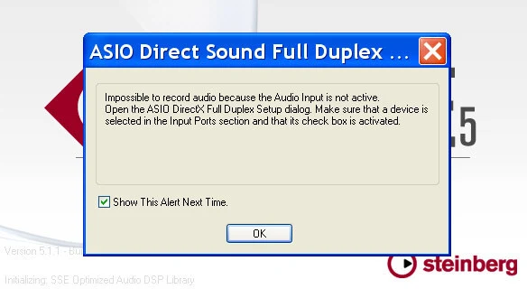

ARG...things are getting worse as i go...
what`s the problem here..this was`nt showing up before..what did i screw up now? here`s a snap shot...this shows up before cubebase even loads..
No biggie dood. You just haven't setup your soundcard yet. That is in regards to your built in one. Continue with the steps. :)
somethings whacked...last night it listed my tuscam, tonight it is not..here`s what I`m seeing..
if I click on "outputs" it`s listing my realtek..??..anyway, last night it was listing multiple channels from my tuscasm, today, it`s just showing ! & 2..i know i was a bit tired when i messed with it, but it was defiantly different..
That is not the US800 driver. Select it from Device Setup. If not listed, then you need to power up the 800 after Windows loads, and before Cubase starts. I can't help anymore til tomorrow cuz I'm out with the wife, and she is giving me dirty looks. :)
AHH HAA!!...we have action over here....perhaps I should`nt have tried messing with it, shortly after taking a few "pain pills" my dentist called me in yesturday..LOL
anyway, I`m getting places now..she`s recording, sound is hearable upon play back etc..so atleast Im getting somewhere..thanks jimmy..I have a long ways to go here, but you definintly get me on the right track now..pun intended..LOL

Have you mapped your VST connections so you get discreet tracks? eg Channel one to track one, channel two > track two, etc. Is Tuscam some kind of Tascam knockoff :confused:

that said, I`m glad you brung this question up, because this was my next question...lets suppose I`m recording live..and lets say, I`m recording 3 or 4 different sources, say a singer, guitar and a bass or whatever, how do I set it up to where they are all bieng recorded on a different track?
thanks..
Follow the same steps for each input. Create a bus for each input channel, and select the appropriate bus in the Inspector of each track. :D
