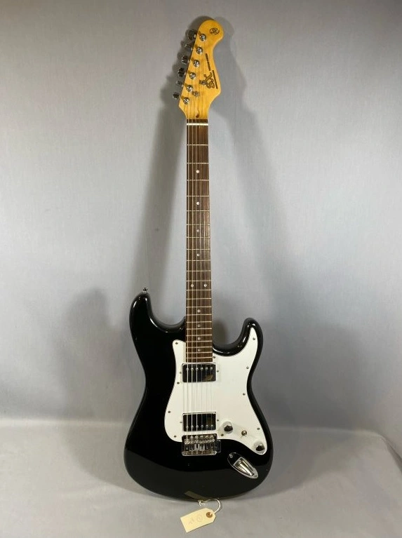

How many P90s did you add to your (cheap) strat? Is your strat a 2-pickup model (not the usual 3-PU style) like this one with two humbuckers?I use a relatively cheap strat that I modded by adding a p90
it was originally an HSS, but it replaced the bridge humbucker with the p90. I wanted something a little more snappy. The humbucker buzzed a little bit before, but now it's a lot. I think i'm just gonna get a noisegate pedal, but it's still relatively irritating.How many P90s did you add to your (cheap) strat? Is your strat a 2-pickup model (not the usual 3-PU style) like this one with two humbuckers?
