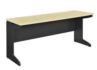

the desk I'm going to buy is this one:

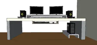

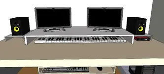

and i'm going to build it like this :
I'll buy wood panels and planks for the MIDI keyboard and the speakers, and i'm going to get a panel for the keyboard and mouse also on the bottom of the desk as shown above.
here are my questions:
1 : 1 x 2 x 8 Primed Finger Joint Board-347154 at The Home Depot
this was the type of wood I was going to get. is this a good choice?
2 : if I want to get a board that is about 40 inches wide and 12 inches deep, and 1 inches thick for the MIDI keyboard, would the home depot workers cut the board as I want? which is 40"x12"x1" ?
3 : is there any changes you guys would make?
4 : other than home depot, is there any other good hardware stores that would fit my needs?
Looks good. The only thing I can see is the position on the monitors. Can you get them up high enough so they are at ear level and do they go back far enough to form the magic triangle placement formula?
Are you planning on recording right there at the desk? If so is the tower/fan on your PC/MAC going to be isolated more? The Op is correct if the desk is working height from a chair the monitors look a little low......once you get set test by raising them up and you will notice the triangle concept......good luck and happy studio!!!
Hey andrew, Great idea! I think of myself a master diy'er, so this is right up my alley. While I'm no professional carpenter I spend most of my spare money at home depot to build stuff. The boards you posted would not be in the list of boards to use. It's only 1.5 inches wide. You'd do better to just buy wide boards to use as the shelfs and legs. The guys at home depot to my knowledge do not cut boards like that. They will cut down a 4' x 8' panel of plywood on their big cutter machine, but they don't do boards. They expect you to have a saw and cut it yourself.
It would be worth your while to ask someone though. Try to go during the week in the morning, not too early, all the contractors will be there. It should be mostly empty and they will be much more likely to help you do a bunch of cuts. I've gotten lucky and one time a guy spent 35 minutes making a whole ton of cuts to tiles I brought in. So it's worth asking. Give them a puppy dog look, like "I've never seen a tool in my life strong man... can you help me." haha.
Here's what I would use something like these - 1 x 12 x 8 #2 Whitewood Pine Board S4S-458538 at The Home Depot
1 x 12 x 6 #2 Whitewood Pine Board S4S-458511 at The Home Depot
1 x 6 x 8 #2 & Better Kiln Dried Whitewood Board S4S-914770 at The Home Depot
1 x 8 x 8 #2 & Better Kiln Dried Whitewood Board S4S-914835 at The Home Depot
They have all these type boards in one section in the lumber part, but next to the tools, not the end with the roofing. If cost is your limiting factor some are cheaper than others, but you get what you pay for (for the most part). Cheaper wood will be more likely to be warped a little, and my not be as pretty. Anything 1" nominal should be strong enough. Anything thicker will start to get mighty heavy. The boards look different, if you are not going to paint it get something you like looking at. If you are gonna cover it with some stain or paint, get the cheapest that looks strait. Lay them on the ground to see how level/ strait they are.
I would use brackets for all the corners to make them square (and help them stay that way). Something like this: Everbilt 1-1/2 in. Zinc Plated Corner Braces (4-Pack)-15304 at The Home Depot
So my parts list would be: 6 packs (4 ea) of the brackets. Screws to use with the brackets (make sure they are shorter than the board is thick). I would also get some 1.5" wood screws to put in the butt of each corner. Wood glue would be good too (if you like buying things) to put in all the joints. And enough board to do everything.
Tools list would be a circular saw, drill, screwdriver, ruler, level, vice or clamp, 90 degree angle.
Other thoughts, if you are going to ask them to cut everything BRING A LIST of the cuts you need. They are NOT going to stand there while you figure out the lengths you need. "Uh.... let's see.... I guess another foot long one".... no. Bring a succinct list - 54" x 1, 26" x 2, etc. Don't give them guy the list either, he's there to 'assist' you, not do your work for you. It's a partnership.
And now that I think about it, they are not going to cut the short lengths you will need for the 'legs' of the shelfs. Those are going to be what, 4" each. You'll have to do those. If you can't fit 8" board in your car, they will most likely cut it down a bit for you, just make sure they don't cut it too short for you to then use.
I feel as though I'm rambling now. Let me (us) know if you have any questions. I love supporting people doing things themselves. It's a beautiful thing to look at something you've build and be proud.
Good luck my friend.
Oh, and I've found Lowes to be more friendly workers and cleaners stores.. However I still love Home Depot with all my heart, yeah it's funny but true.

1. get the desk (Altra Benjamin Desk in my case), and get the materials needed for the shelves(sandpaper, wood, paint, etc)

It might be cheaper and quicker to buy an off the shelf (no pun intended) keyboard/mouse under mount shelf.
One suggestion: on the 40" long midi shelf, I would suggest a stringer across the back. This will stiffen the shelf and reduce the sag that WILL set in.
Also, even if you choose to go with brackets inside the shelf, spend just a bit more and buy some wood glue, and glue all joints, as well as adding the brackets.
thanks for the suggestion! i didn't think about the sagging and all that stuff. I thought it would just sit still forever :P
although I have a few questions to ask - what is a stringer?
If I don't want there to be a sag, should I add in another "Leg" to the midi shelf in the back to be able to support the weight of the monitors? so the shelf would be blocked and supported by three sides, left right and back.
A stringer is almost what you are talking about. It would run across the back, attach to the two side and to the bottom of the shelf. It would not extend down to the desk level so you would still have room for wire and cable to exit. But you could just as well make it come down to the desk (stronger) and just put some small notches on the bottom edge for the cable routing.
