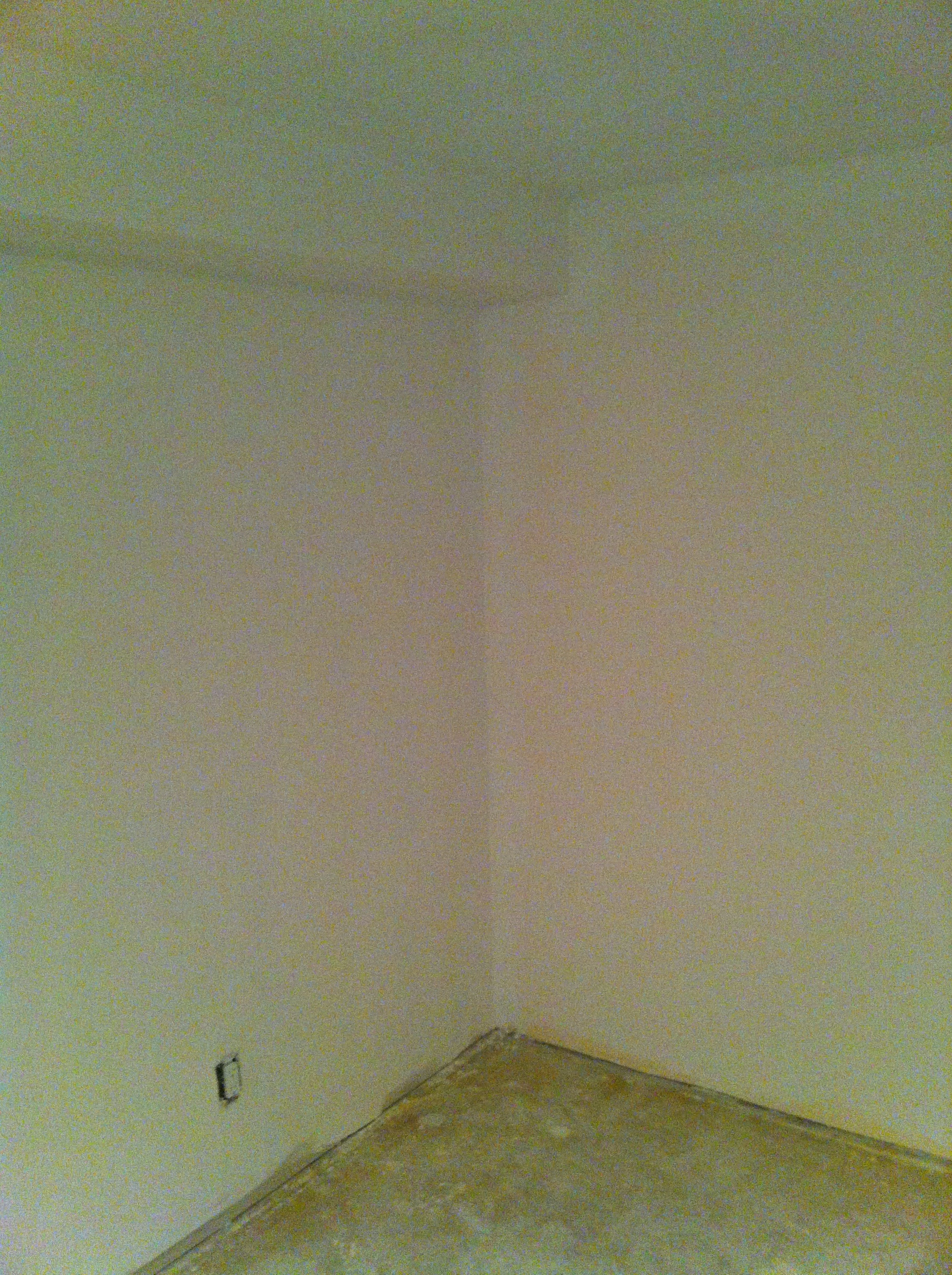

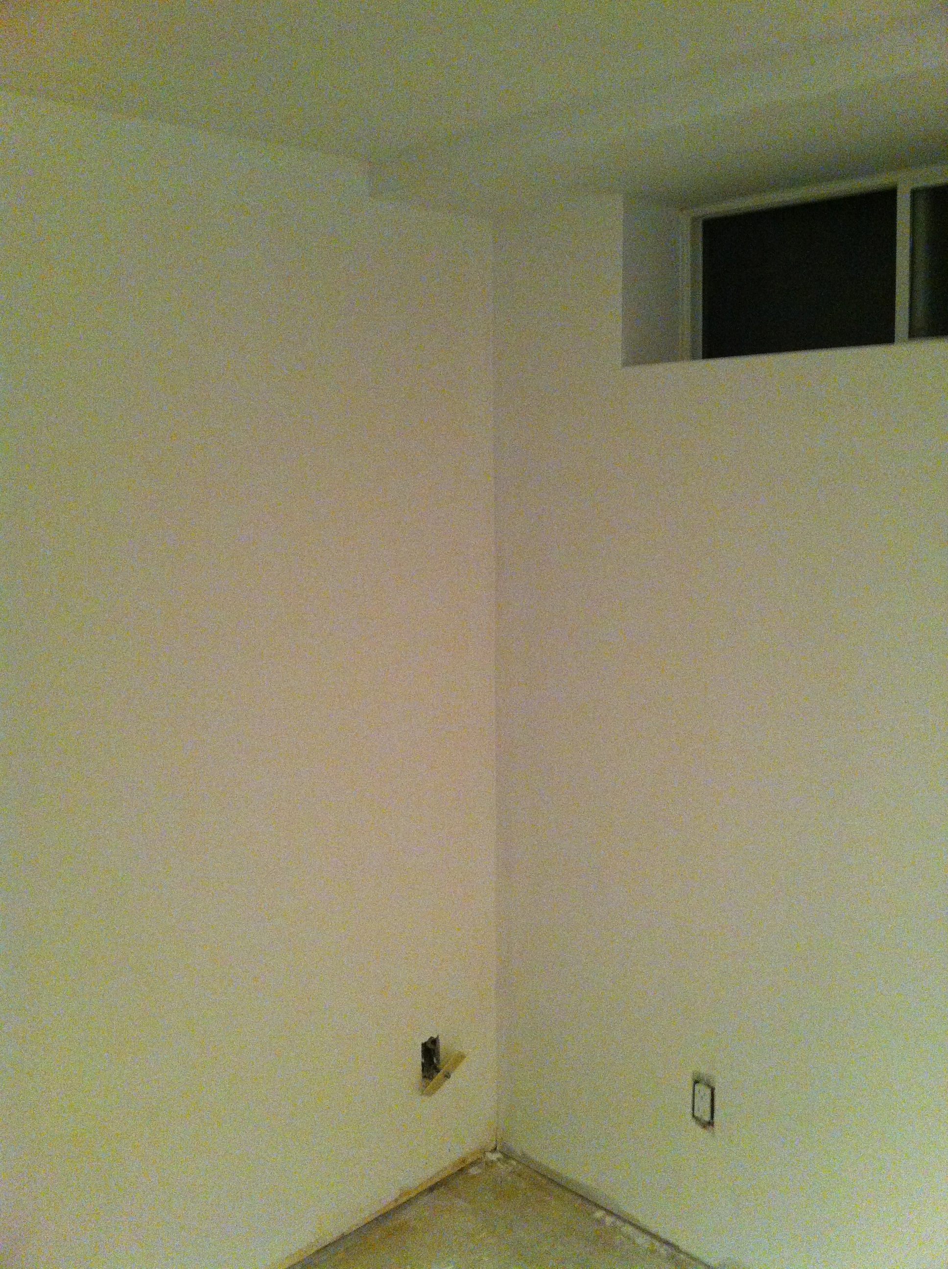

After I finish painting the studio, I will start installing my corner superchunks (4 vertical corners of the room). The back two corners where the drums will be, are bare and have no bulkheads, but go figure, the other end of the studio where my mix position will be has bulkheads of different sizes on either side. No I can't switch ends and have mix position on other side, and it's due to the way the room has been "soundproofed" (i want it so the drums are furthest from door the weakest link). In my hopeful opinion, the bulkheads aren't so bad or obtrusive as to have a dramatic effect on room acoustics.
The ceiling is about 7'2" high (not including bulkheads). How would you superchunk these areas? They will be the standard 2' wide (face) superchunks (I think that's the standard). On the side with the window, the face of the 2' wide superchunk would extend past the left edge of the window box.

On that top pic.... how far from the corner is the electrical outlet? And do you want to keep that TV cable hootcher?
I think the chunks I made were 17 inches across the front. I cut them from 2 ft X 4 ft Roxul, first cut in half making 2X2 squares then diagonal in half to make the triangles. So if that's similar to what you're thinking, I'm pretty sure it was 17 inches across the front.
If you don't care about the TV thing, cover it. Stack your triangles up just like normal and don't worry about that little bit at the top. Or the window. You could notch for the window but if it were me, I'd just leave it.
Maybe after you're done, you could do some small horizontal trapping across the tops of the corners but I'm not so sure you'll actually need it.

I don't care abut the outlet or the tv connection on the right side. I am covering them. There is no fire hazard since the insulation is fireproof, but I will put little child safety things over top of it. On the left side, the plug is far enough away.
I am using Roxul which is about 15" wide. So cut diagonally and placing 2 squares side by side, the front face will be about 30" or so. I am pretty much making these but with wayyyyy less clownf*ckery that this guy does for no reason (added work). https://www.youtube.com/watch?v=TUlW6BenyWg
I don't want to just have open space up above where the chunks would have to stop due to the bulkheads. I want to somehow keep them going but cut into the shape at the top a bit. I just don't know how that will work with the fabric stretching. And covering the window partially is extremely ghetto and blocks natural light. I'm not going through all this painstaking work of finishing a beautiful new room from scratch and then doing shoddy work at the end like covering windows halfway. haha!
