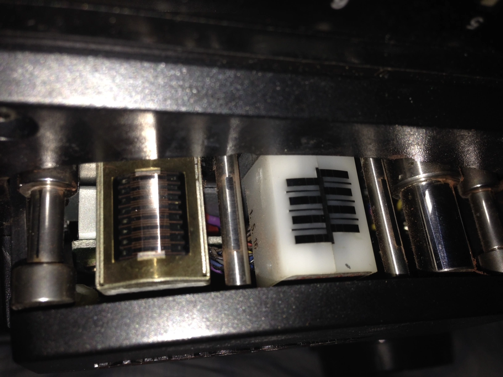

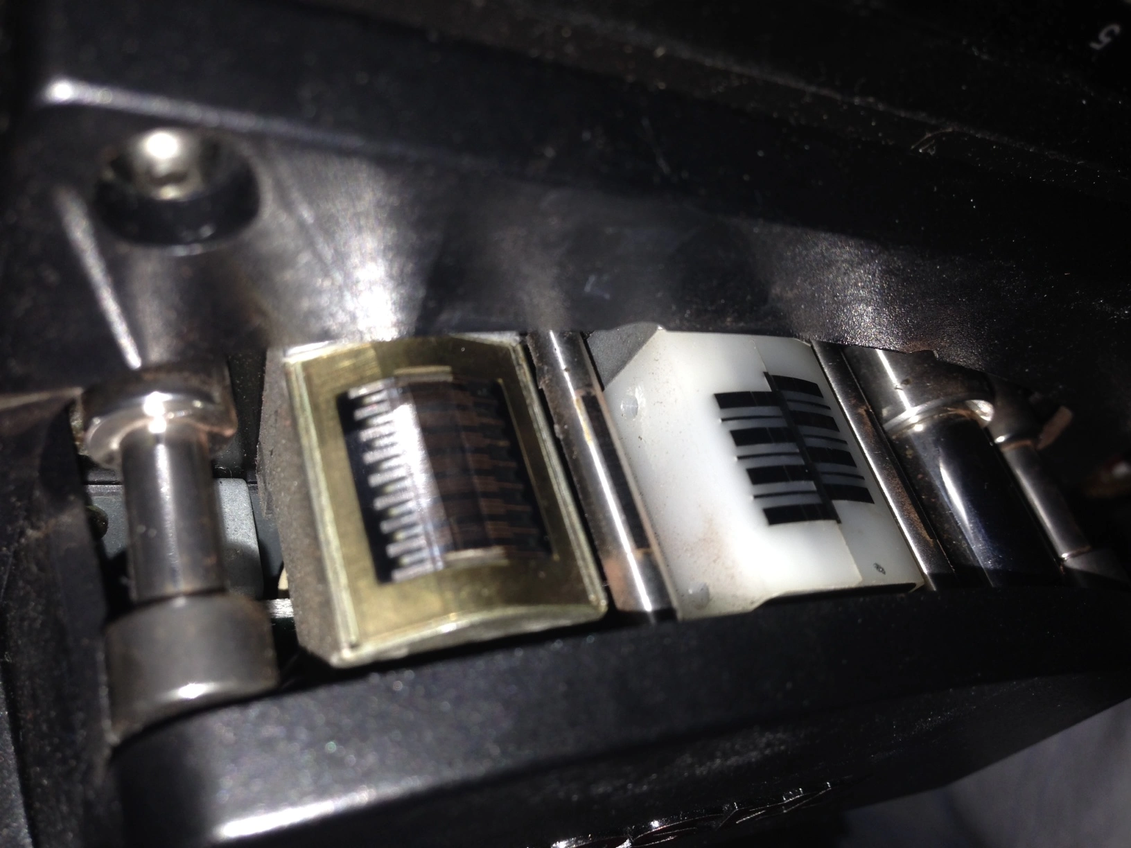

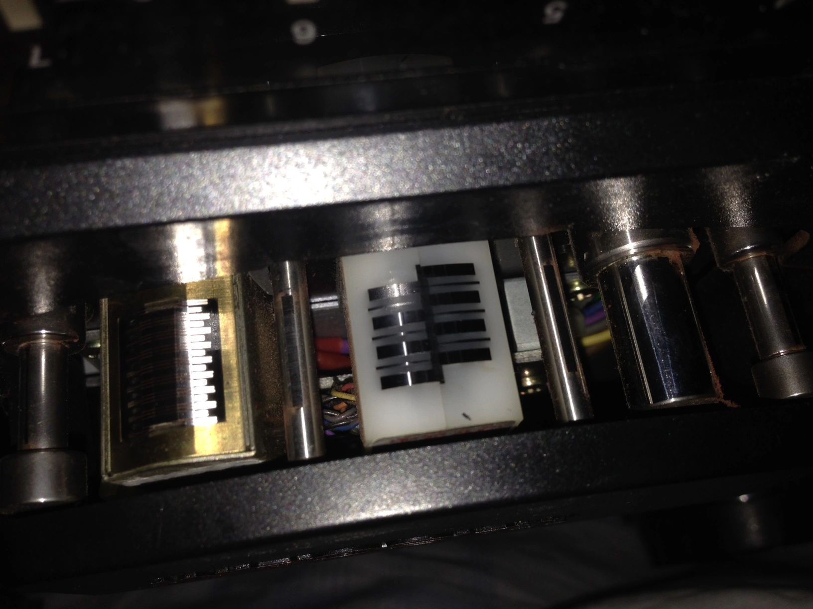

I don't think they need relapped but you have to take that with a grain of salt because there is NO way to make any sort of accurate assessment from a couple pics posted on the internet. And that's why I said the proof is in the calibration.
Bottom line, if you can get all channels to line up in record and play and the frequency response is in spec, and the tape passes through the headblock clean then you're good to go.
You've owned it since new?
And if so how many hours do you think you've put on the heads just ballpark? Or how many projects have you done on it?
