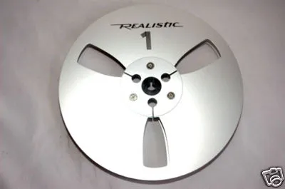

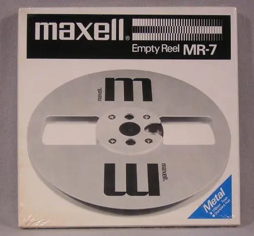

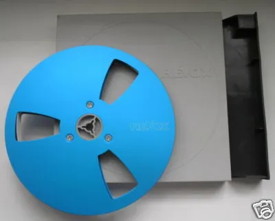

These 7" reels look like they can be taken apart in the usual way as larger ones?
Can't be 100% sure but they look similar to 10 1/2" reels that unscrew & come apart?

There are certainly some 7" reels that come apart, like the ones that Transcendental posted pictures of. But I just did a quick eBay search ("7 reel metal") and found that some, the Maxell, are selling for well over $25 us. I wouldn't pay that much for a 3M precision (6 screw) 10.5" reel.
